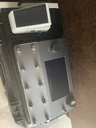

So I learned today that there is a HUGE difference in an instrument cable and a TRS cable. Herp Derp! I got it working now with the Dunlop X8. I seriously thought they were the same cables.
I tried my Source Audio Reflex and it works great.
The LFO function also works perfectly
Did not test the MIDI function though
