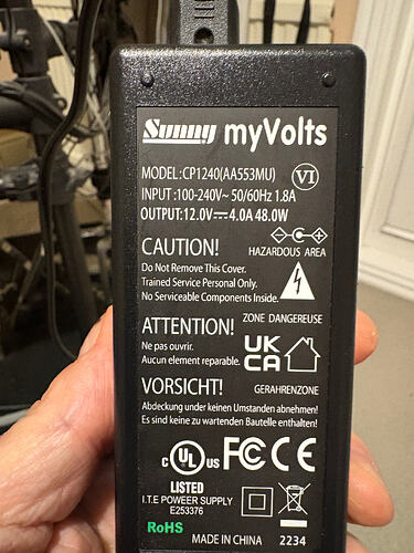

I’ve just bought a secondhand QC and as well as the original power source, it had a back-up power supply (see photo). Is this suitable for the QC? Also does anyone know if there’s a means of locking or fastening in the power connector as I’m worried that it would be easy to accidentally pull out on stage. Thanks. S

12V 4A is fine. I have similar specs on the power brick I use for my QC.
However, that brick is center-pin-positive. The QC’s power input is center-pin-negative. You may damage your QC if you try to use that power brick as-is. You can get a polarity reverse cable pretty cheap on Amazon or through Voodoo Lab and it will safely convert to center-pin-negative for the QC.
The other thing is to make sure you’re matching the correct barrel size. QC has a 2.1mm pin, same as any Boss-style pedal. It’s not clear what size of connector your power brick has.

This symbol right here will tell you if the power supply is center-pin negative or positive. Every power supply will have this somewhere. In your case, you have the positive being applied to the center (of the connector). This is the opposite of what the QC needs.

As for having a backup, make sure the connector end is a 2.1mm barrel connector so it will “grip” the pin of the QC appropriately. Center negative, 12V with a minimum of 2A (but more is OK), and you’re good to go.
You can also cut the cable and invert the connection.
