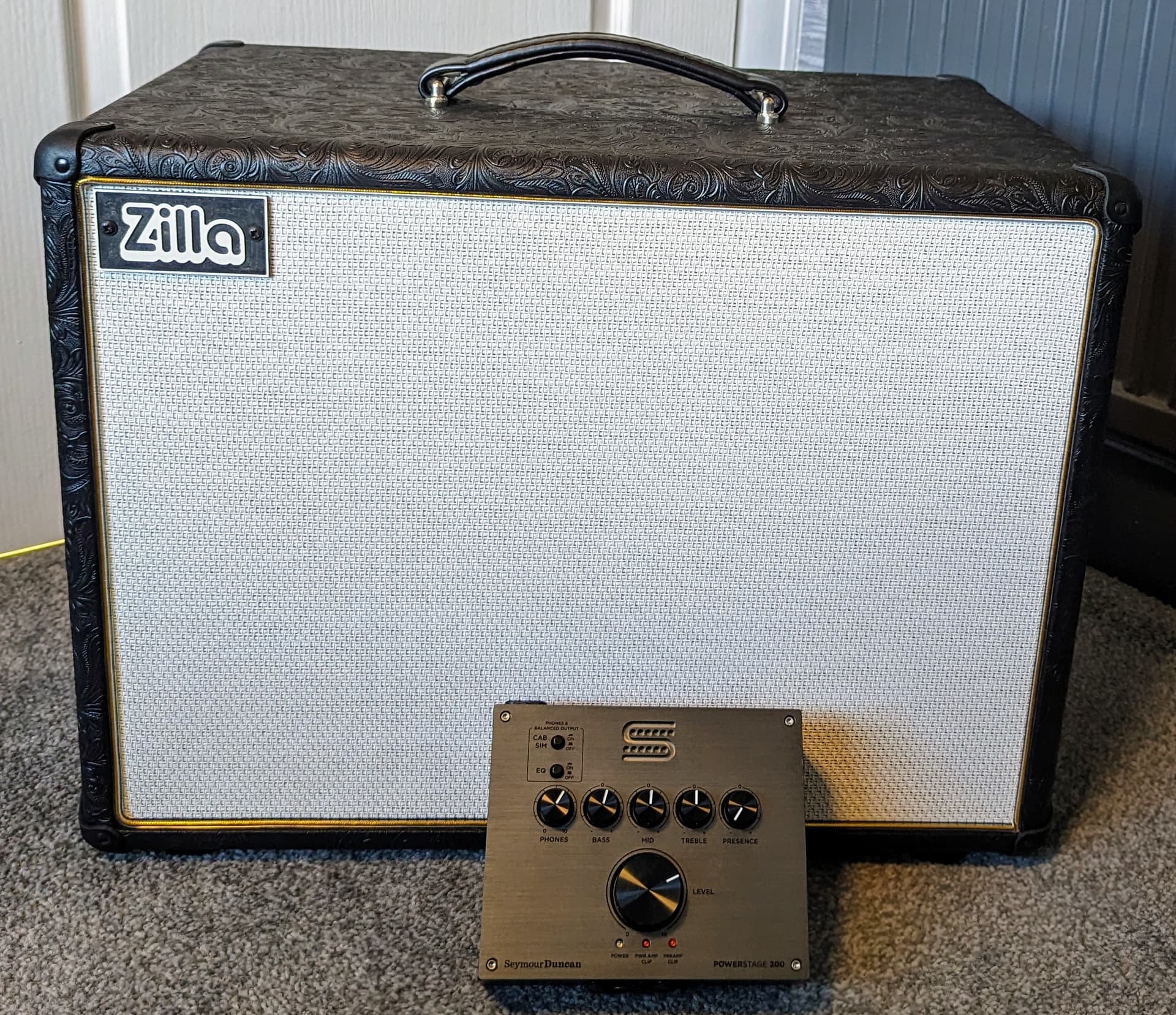

I have been using a headrush frfr 112 for some time but I really wanted something that looked like a proper amp cab.
So research led me to the celestion F12-X200 full range speaker developed for modulars like quad cortex ,kempers etc.
And I was inspired by the Mesa/Boogie Thiele Compact ported 1x12" Extension Cab, they sound huge.
I contacted Zilla cabs here in the UK and they made me a custom cab designed for the x200 speaker
X200 cab build
I would power this with a Seymour Duncan powerstage 200 .
All in all it looks and sounds excellent, I specified white speaker cloth and black western tolex.
Does look very custom boogie ish.
Came in at about £450 with the speaker I specified.
Add the powerstage and your looking at close to £900 but it looks better than a headrush.
https://www.zillacabs.com/
That looks great!
