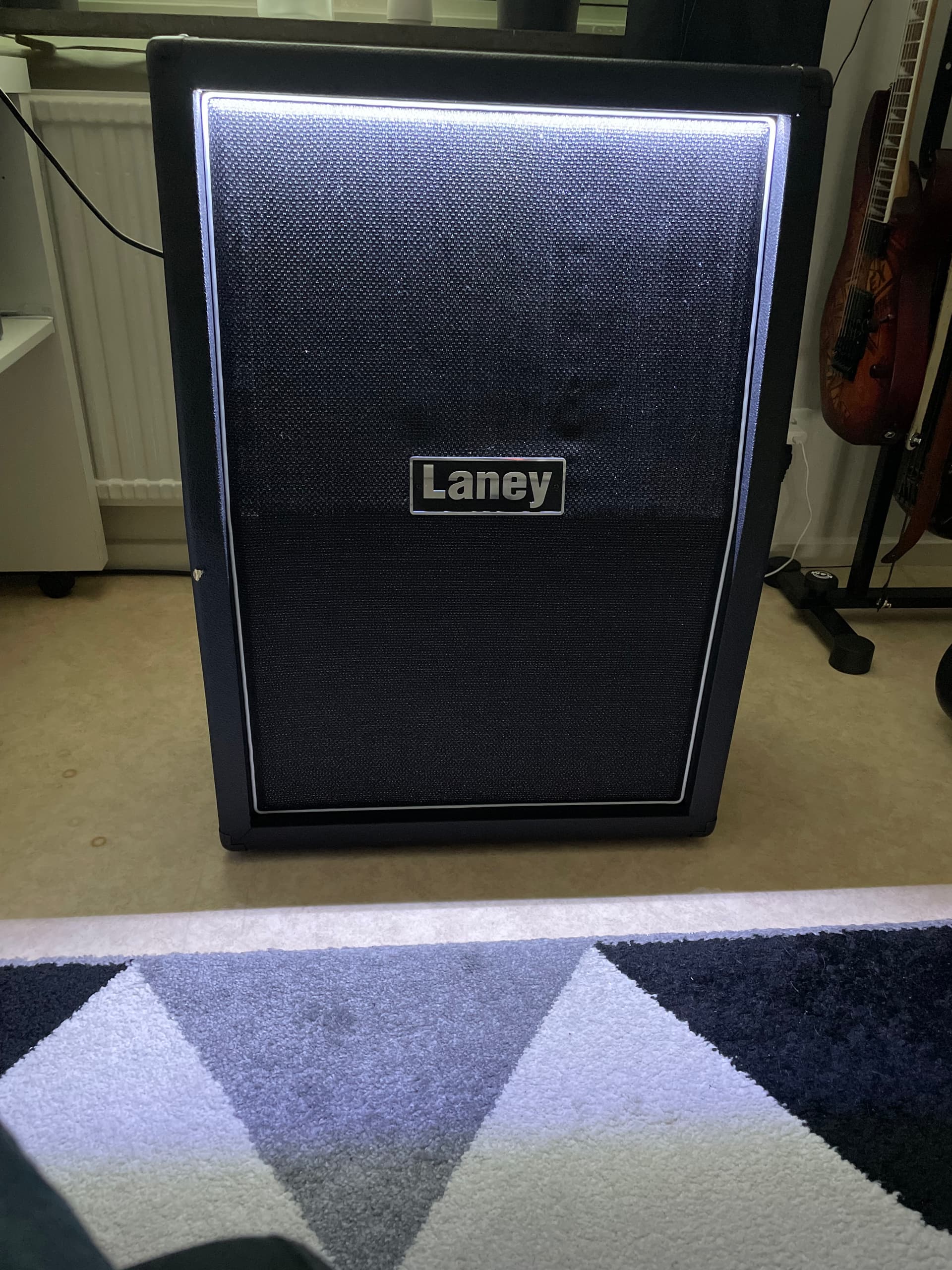

I had a Laney LFR-212 delivered today. I paid about 140€ for it brand new with a small transport damage on the Tolex. Works perfectly!
Congrats & welcome to the LFR club; the LFR series is the best bang-for-your-buck FRFR solution on the market at the moment IMHO.
