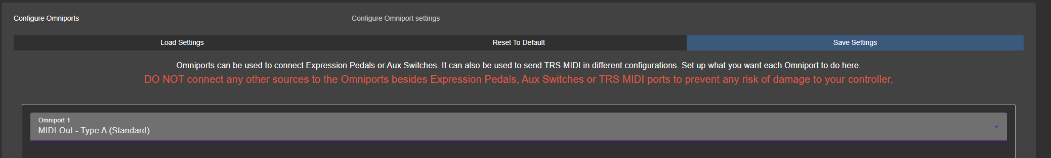

I have the MC8 Pro, but I’m sure it will be the same on the MC6. One thing you might be overlooking is setting the Omniport to MIDI Out - Type A (Standard). Be sure to hit ‘Save Settings’.
Let me know if this resolves the issue.
Good luck!

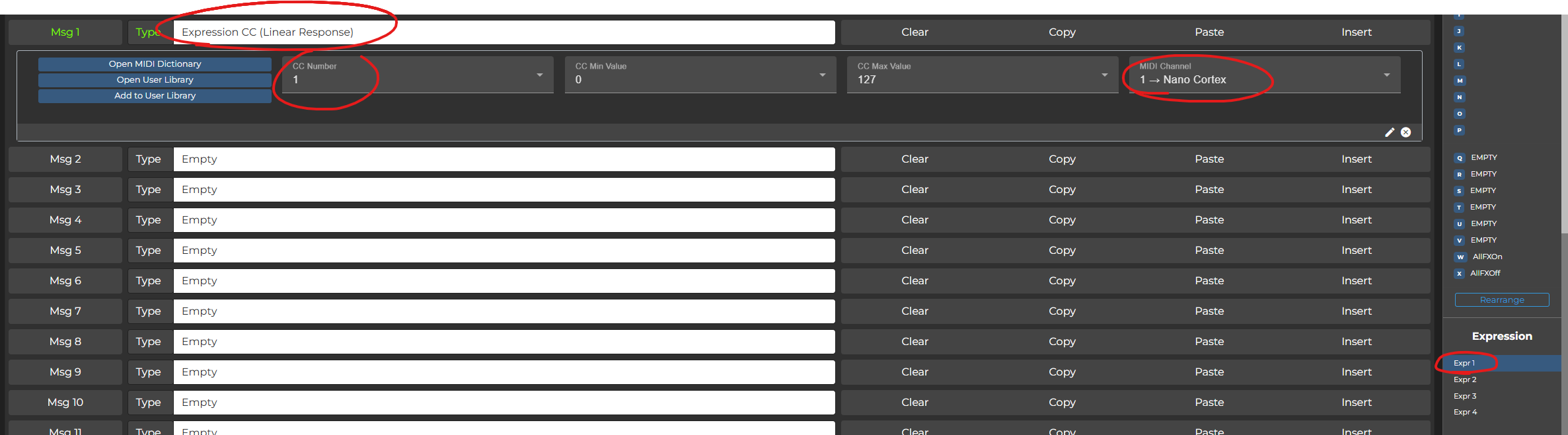

Here is how I have my expression setup in the Morningstar Editor:
Where I have my DVP4 going into the Omniport 1 (I think for you this is EXP1 on the MC6), and then Omniport 2 (EXP2 for you), is a TRS to TRS cable to the NC EXP/MIDI In.

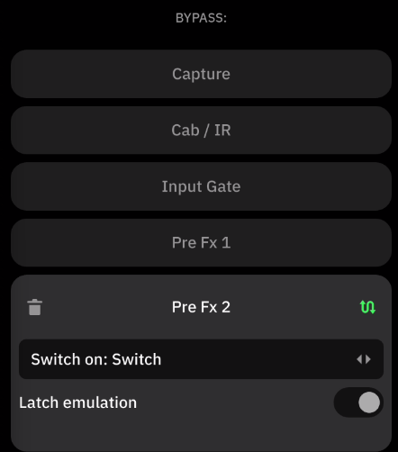

Here is my configuration for the NC:
For posterity, here is my configuration in ‘Expression Pedal’. This toggles on/off a Wah on PREFX2 slot, and also controls the Wah amount. Again, as you’ve mentioned, switching back to MIDI mode after configuring.
Lastly, you may need to check the MIDI Channel Settings on the MC6. IIRC, I never changed mine. This is how it was by default.
