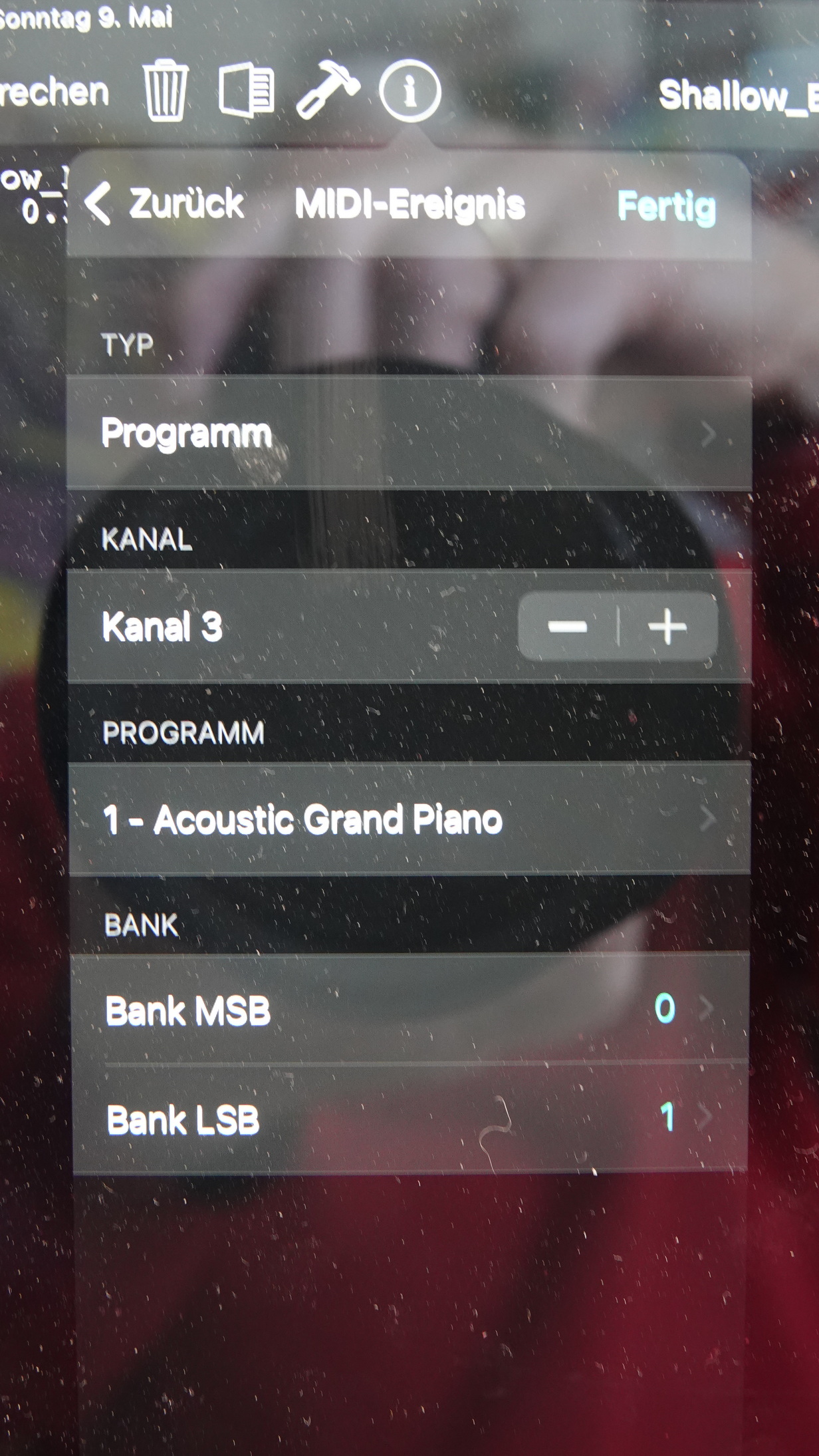

Ok. Go to the song editor and select the (i) bouton to open the Metadata editor.
Go to the MIDI section and select the “send” item. Enter ‘+’ and set the control to “program”.
From select the midi channel of the QC or stay to “All Channels”.
Select the program number from your Bank 1: 1, 2 or 3
Set Bank MSB to 0
Set Bank LSB to 1 to select the directory “My Presets”.
That’s it, it should work when you select the song from the app “OnSong”.
@RJMiddel @xtian.bonnin : Hey men, you made my day
With your help I’ve got it now. I have set QC to channel 3, as channel 1 is already in use for my Beatbuddy. And with the shown settings in Onsong, it works now perfectly, both on the QC and on the Beatbuddy.
