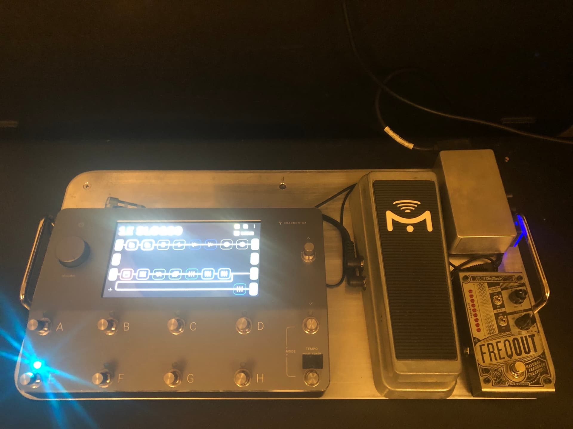

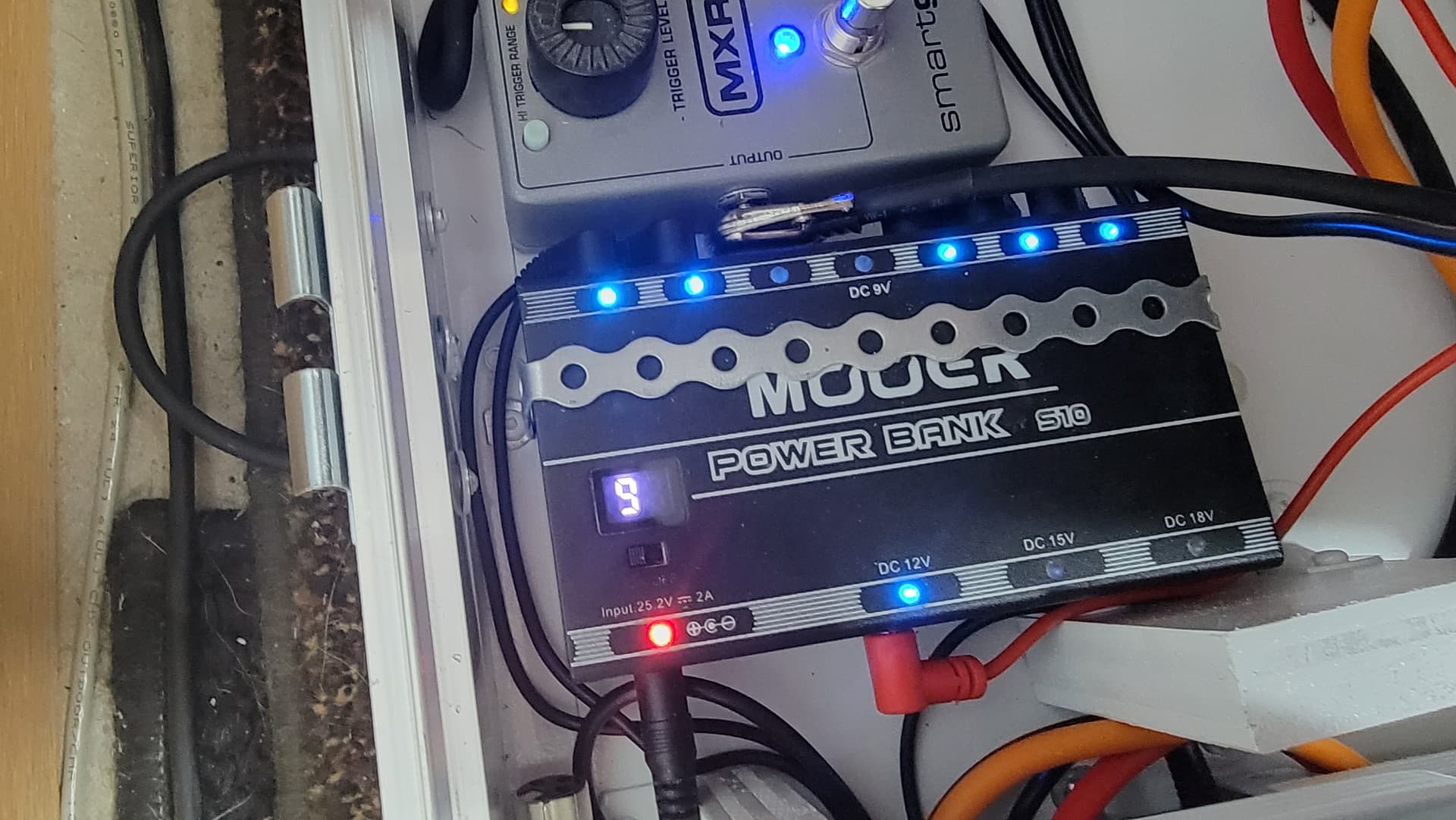

I’m using a Mooer Power Bank S10. This is a battery-powered power supply. It has a 12v port as well as several 9v ports. So, I can run everything. Here is a video I made to test the S10 with the QC: (2) Neural Quad Cortex /w Mooer Power Bank S10 Rechargeable Power Supply - YouTube
On my board, I have the QC, a Shure GLXD16, Boss RC-500 Loopstation, an MXR Noise Gate, an ABY switch (with LEDs), and a Boss FS7 (with LEDs), and a Boss EV30 Expression pedal (which doesn’t use any power). The S10 powers it all. One cable to the QC.
In my video, the QC ran for about 4 hours. I haven’t timed how long it would run with everything connected. But, so far, I’ve just plugged the PS in and it’s stayed at full charge for the whole show.

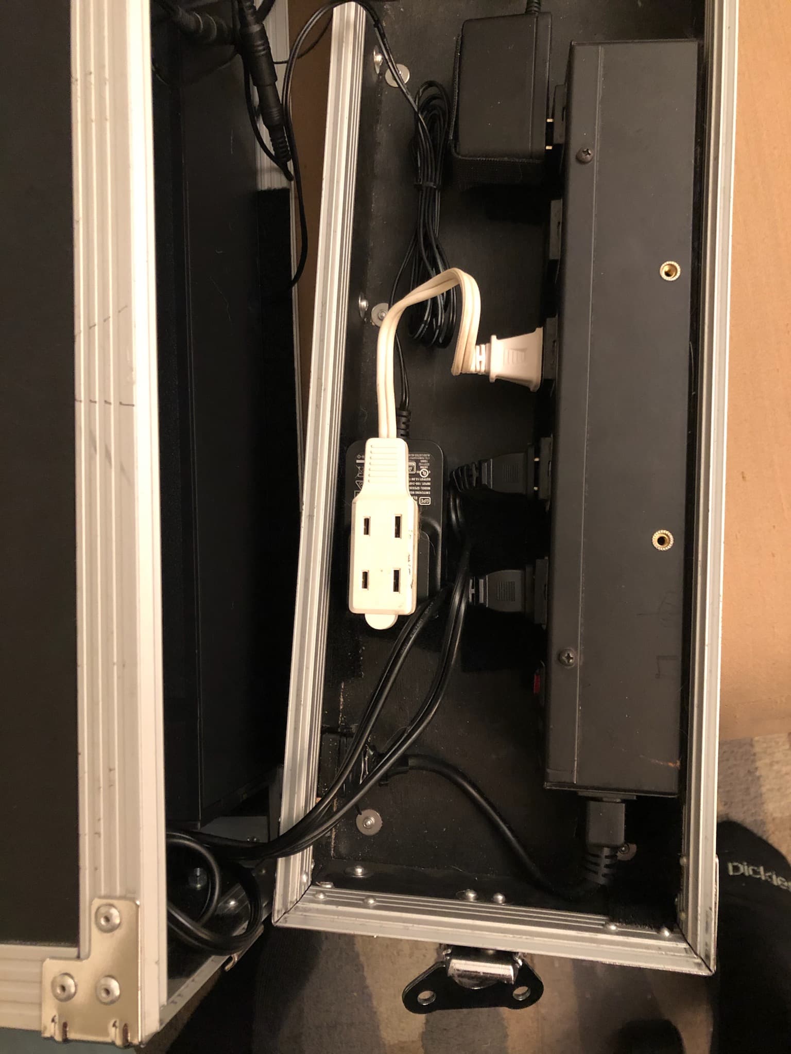

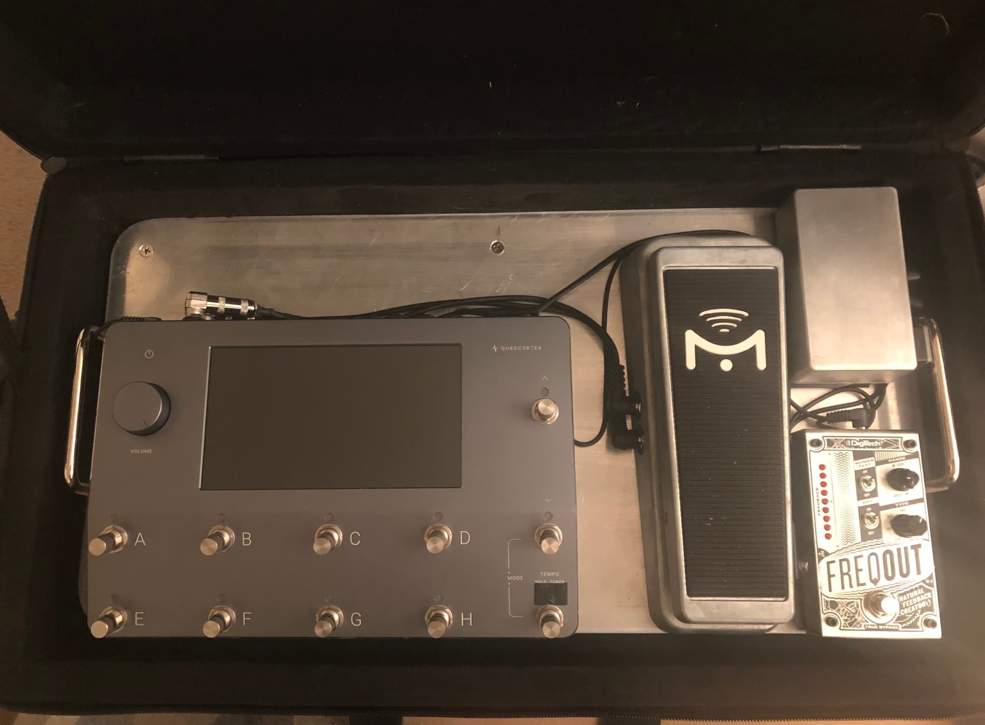

My IEM rig is already in a small rack (I have a half-rack mixer that gives me knob control of band mix and guitar, as well as LR pan for each), and each of the pieces in that are on AC-DC transformers. On my pedalboard I have the QC and a Freqout that require dc power, so I have put the wall wart/transformers for those in the rack with the others. I got a couple of heavy duty extensions and made a loom with them and the XLRs for the QC. It works really well so far! If that doesn’t work, I’d suppose I’ll go to a Temple or other type board and mount a Cioks DC7 underneath. For now, I’m saving the money for that and the cables it would take to get enough amperage for the QC. The rack sits face up, and the loom is about 10ft long so it will set just off to the side, where I can get to the volumes for my in-ear mix. This is the top view:
And this is the bottom lid, where the power supplies live:
I put an IEC on the side so I don’t have to open it to power the rack:
And so here’s the pedalboard…just a piece of aluminum:

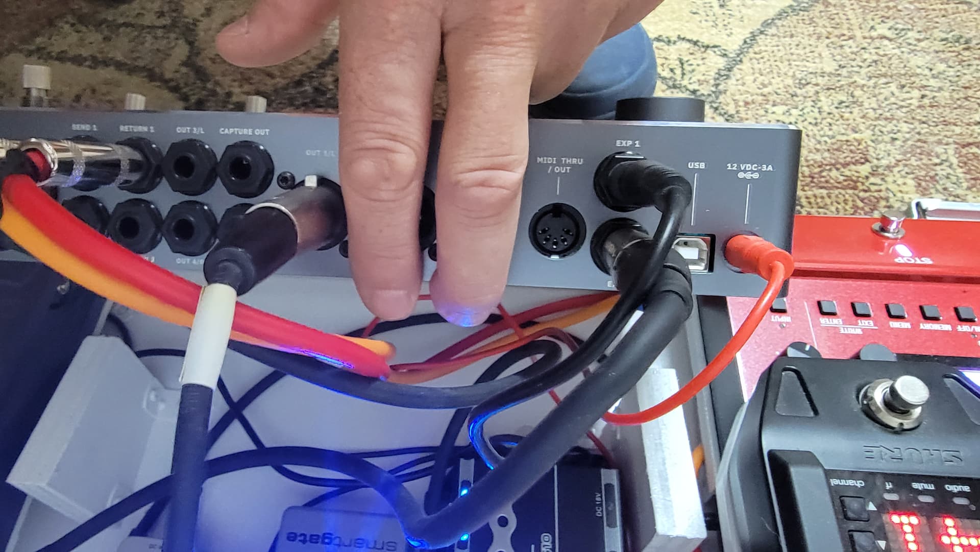

WOW!! I wish you would have shown the back end of the QC, and the power connection. It’s GREAT to see a power bank powering the QC.

The on/off switch has no effect on it powering up when plugged in. It’s a ‘soft switch’ and only turns it off.

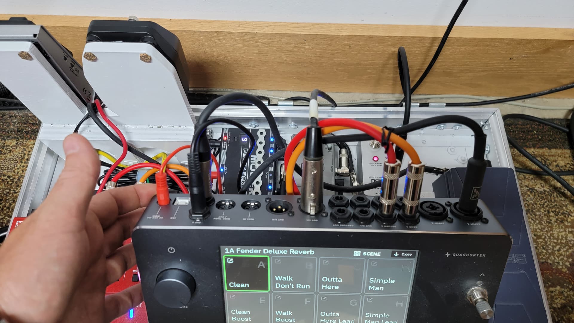

The connections aren’t much to see between the QC and the Mooer S10 Power Bank. It’s just one cable plugged into the 12v outlet on the S10 and then it goes directly into the QC.
The sections that hold the upper-level pedals are hinged to allow access to the wiring below. The QC is on a hinged piece for the same reason.
I took some photos:

The Mooer S10 Powerbank powers everything you see in my pics, including the Shure GLXD16. While it can do this on it’s internal battery for about 4 hours, I just plug it in on stage. Then, it acts just like a regular plug-in type of PS, but with the current carrying capacity to meet the demands of the QC and everything else on my board.
