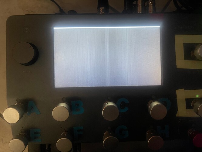

So I just did the latest firmware update and boy do I regret it. Worked fine for a couple of days and all of a sudden, the QC shut off on its own then started flashing blue LED lights then I got the grey screen of death and that was it folks. Damn I miss my Kemper Stage.

Of course I am using the proper power source. I contacted neural support before I posted on here. It’s been 24 hours and I’m still waiting for them to respond. Meanwhile, I have a dead QC on my pedalboard.
I’d suspect the SD card needs to be reseated.
I suspect that as well but I’m not not opening up the QC. Don’t want to touch anything that might void any warranty
yup that fixes most QC problems
no seals on unit sd card is replacable its got me going again on more than a few occasions open it up reseat sd card and reboot

Thanks. I’ll be in touch. Right now, I’m trying to do an install of my April backup. Gonna see if that works. But I’ll be in touch. Thanks
Mine has been bricked as well. Just pulses blue. I was so excited to get this now it has become a huge regret. I’ve had it less than a month.
This is all messed up. After three emails , they finally responded back asking for an original invoice and serial number and once I sent it to them, they tell me to call Sweetwater for repairs etc. just like you , I’ve had mine for about 6 months and was getting some good sounds. Now, once I get it back, I don’t know what I’m gonna do with it. This last long awaited update was a bust also. Yay! On screen tuner. Anyway, let’s just what kind of run a around I start getting

I came from Kemper and Fractal so yea I was quite aware of doing updates right away. But I guess I fell into the hoopla of the updates since it had been a while that an update came out. What’s ironic is that this latest update didn’t even benefit me as a user but still went ahead and did it. Lesson learned. I always wait to see how other users came through with their updates, but not this time. As far as the return policy, once Neural emailed me back after I sent them three emails, they told me to contact Sweetwater. Sweetwater took three more days to contact me back and when they did, they sent me a two day shipping label back their repair department. So it was a little bit of a run-a-round. Should get it back in about 4-5 weeks.
Did you resolve this ever? I just got grey screen after updating 4.0.1
