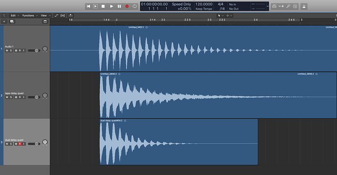

I recorded a few examples into logic to compare.
Top is my Timeline, second is quad’s tape delay and third is quad’s dual delay.
Even with mix cranked very high on quad, the drop off is a lot quicker than I am after.

This example was a long feedback, but it is the mix level that I am lacking as well.
You can see in the top audio track the repeats stay louder for longer, and the mix isn’t fully cranked on the timeline.
I’d love the mix on the quad to bring the repeat volume up a lot more.
