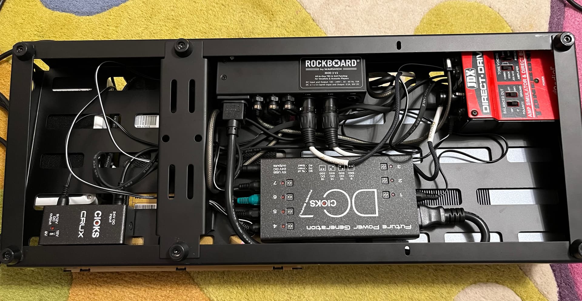

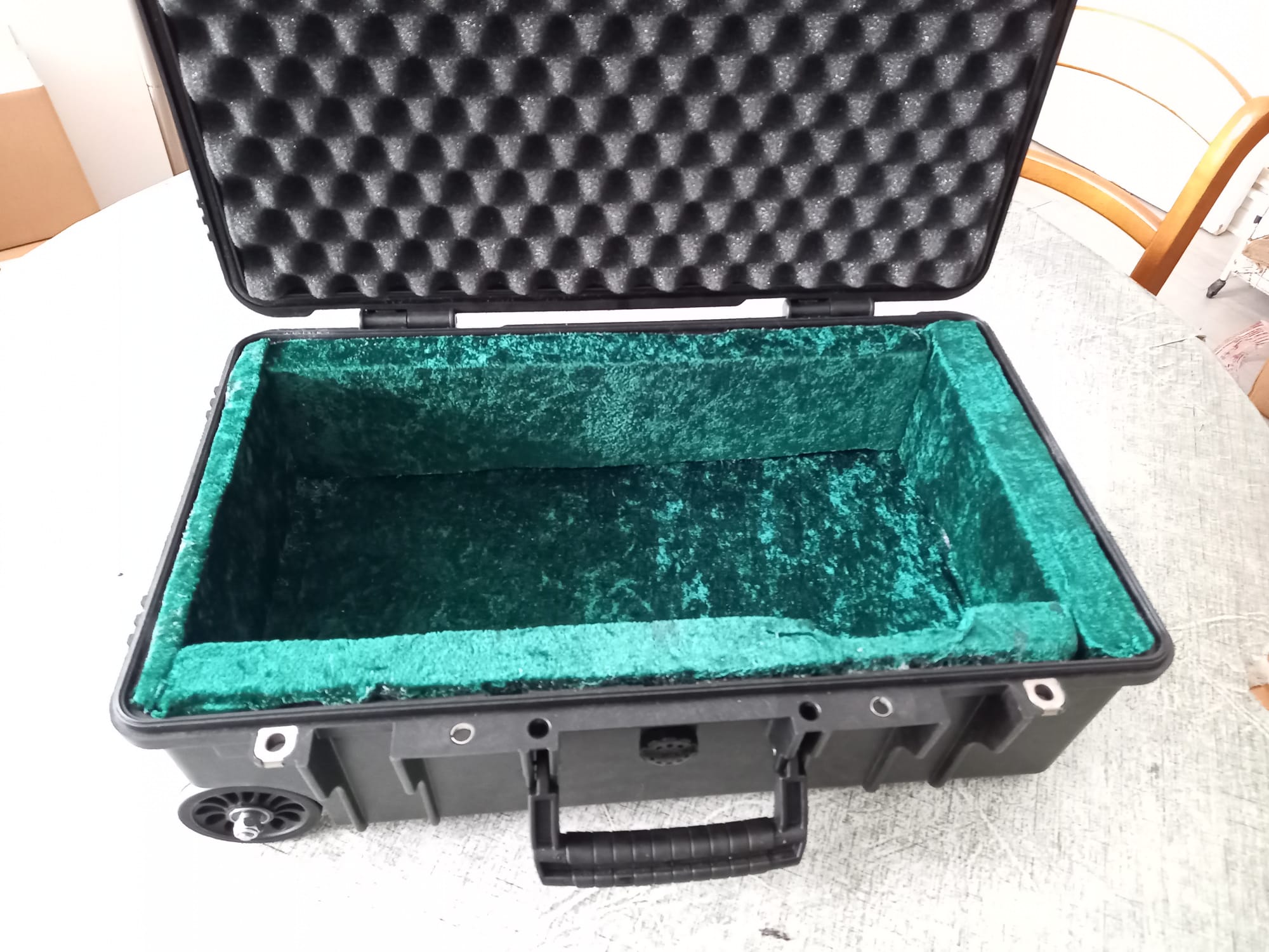

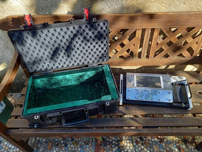

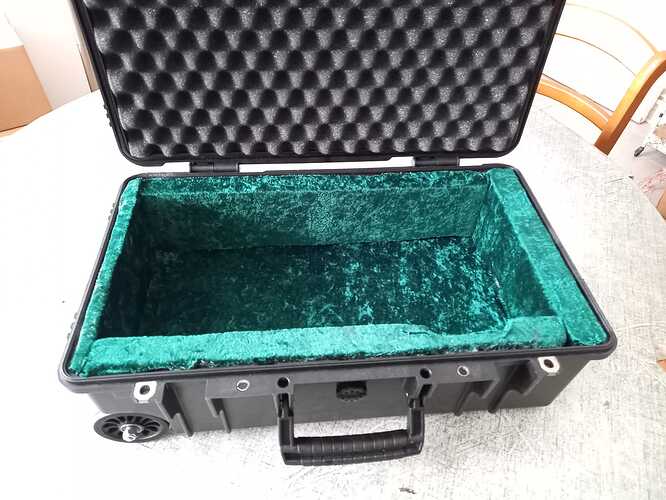

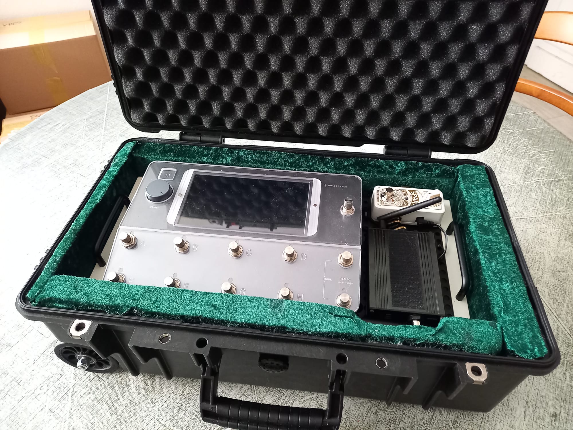

I just finished building my pedalboard + hardcase, and since I struggled to find what I wanted, I thought I might help whoever needs something similar :
I wanted a simple rig for my acoustic guitar, with QC + boost + wireless transmitter, that could fit inside a hardcase compatible with most airline companies… Peli / Nanuk style carry-on cases are often slightly bigger than the max size allowed on some European airlines (ex: 55.6cm vs 55cm, I don’t know if there is some tolerance on the max size, and I don’t want to figure it out the hard way)
I finally settled on the Temple Solo 18 pedalboard, with DC7 & Crux underneath, fitted inside an Explorer 5218 Case, and built some velvet-covered Kaizen foam pads to fill the gaps, glued inside with some 3M 90 spray glue. I struggled a bit to fit the pedalboard inside, because the telescopic handle bars & wheel axle eat some of the advertised inner volume, but I managed to do so with some asymmetrical padding. The Explorer 5117 could have worked instead, perhaps with a cleaner & symmetrical padding, but I really wanted the wheels & telescopic handle :smiley:

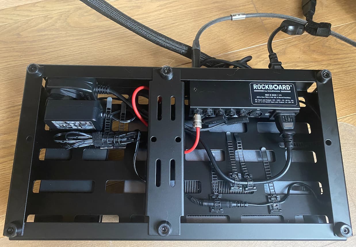

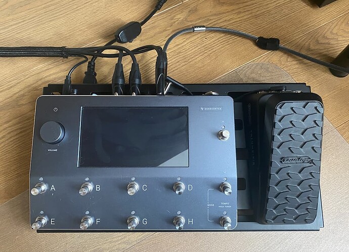

Rockboard Tres 3.0
I used to have a 3.2 and had a power amp and tuner on the board, but recently downgraded to a lighter and smaller option.
This looks great! Can you tell me what you’re doing with the power? I’ve read a few other posters having humming issues with the Rockboard patch bays, did you find this? New QC owner here and weighing my options!
Thanks!
I do not have any issues with the Rockboard patch bay; it works well, and there is no strange humming or any other noise.

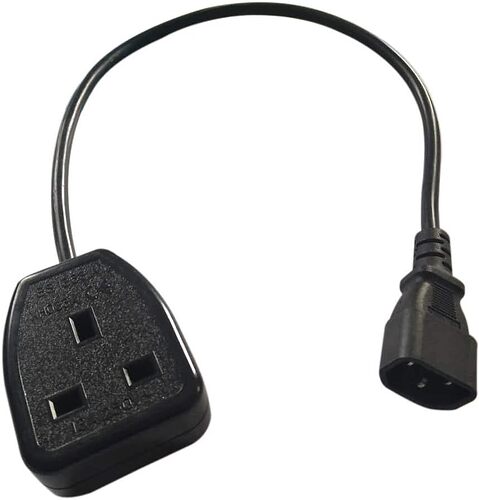

For power, I’m using a couple of simple extensions I got from Amazon.
Power cable from the wall goes into this thing, which has an on/off switch.
This goes into the patch bay, and from the patch bay, I have this mounted under the board. It actually fits perfectly on the side; you can see it on the top left in the second picture. I have used some 3M dual lock to keep it in place.

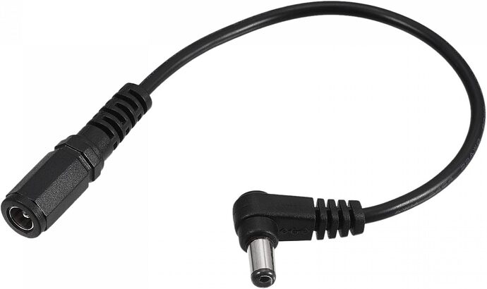

Into it I’m plugging the QC power adapter, which next goes into the QC via an angled plug like this one:
All these extensions were fairly cheap, Amazon or your local electronics store :slight_smile:
Hope this helps!

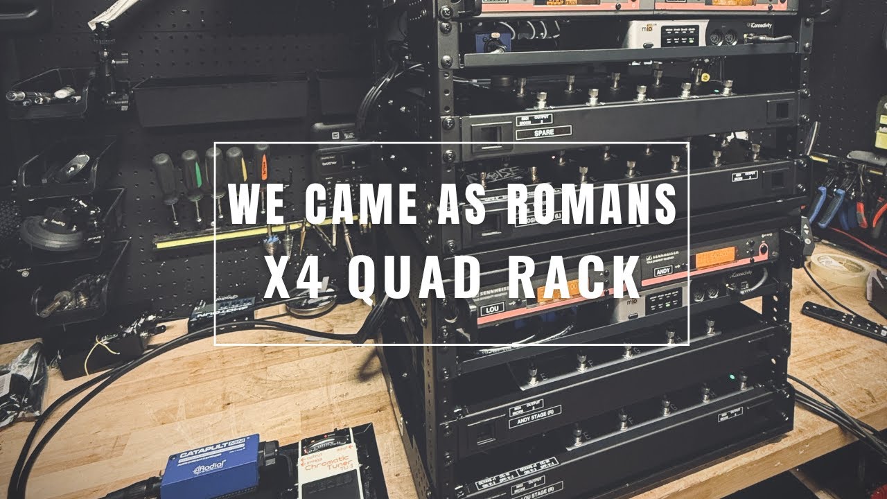

A lot of talk about QCs competition lately.
One thing in support of QC is seeing touring bands put them in racks like this which is pretty cool. I don’t seem to see many competitors going in road racks.
Seems to speak to the versatility of the QCs form factor. Put it on your desk/floor/rack/on a board with other pedals.

Great job – love the case!
