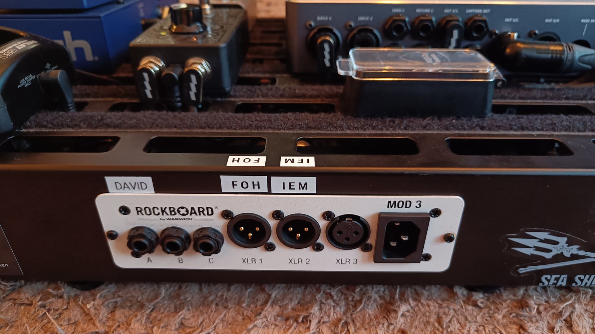

Rockboard Quad 4.2
What is going on with the cable marked in red coming out of the XLR jack? What is that, and what does it do?
That’s just a TRS to TRS adapter, because I use Output 1 (XLR) to FOH and Output 3 (TRS) to our own IEM Rack Mixer. That way I can apply the global EQ to the FOH signal without affecting the IEM signal for last minute adjustments if e.g. the room is a little bassy or the FOH Engineer is asking for adjustments. The TRS to XLR cable I had at home was to short unfortunately but I also already had the adapter and a longer TRS to TRS cable, so that was the cheapest solution without the need to buy or solder anything :smiley:
Edit: The red electrical tape is just there to provide a better grip for the cable ties to hold in place.
