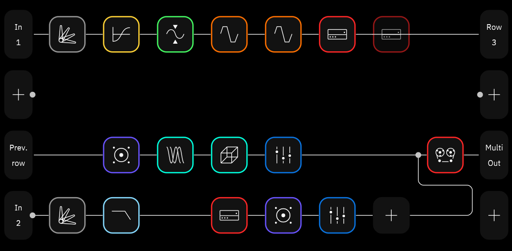

If the looper routing won’t do the trick, your original attempt wasn’t that far off.
No you can’t, but you can do
Input 1 → Row 1 → Row 3
Input 2 → Row 2 → Row 4
And then use a mixer to combine Row 4 back into to Row 3 in front of the looper.
Like this…
Or you could even skip Row 2 and just use Input 2 → Row 4
Thanks Derdoe. This is really helpful!
