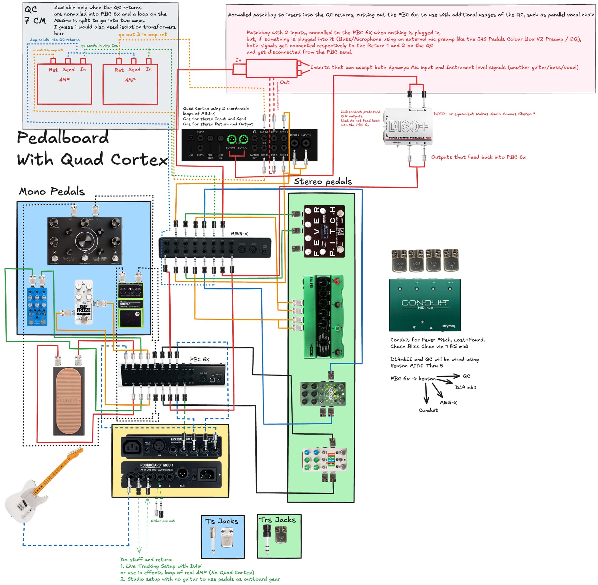

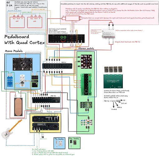

I will have the Quad Cortex wired into a RJM MEG-X loop switcher: Input(s) 1 and 2 and Send(s) 1 and 2 are one loop, Returns 1 and 2 and Outputs 1 and 2 are another loop on the matrix loop switcher. The loops in between are the effects. This is always wired like this… or at least, this is a project, here is the complicated version I was theorizing, let’s pretend the 7CM is not there:
Here is the basic starting one:
Some basic usages i want:
Zoinks! That is some advanced routing, not to speak of some impressive signal flow diagrams. I think you’ve got this.
