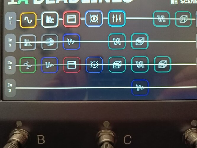

I’m fairly new to the QC and trying/testing around for a couple of days now. My question at hand:
I’ve created a scene with 4 lines so I can switch from rythem to lead to clean/ambient tones, with a fourth row where I combine a flanger with the rythem tones.
Rythem & Lead scenes are the same amps whereas clean and ambient share another amp with other effects.
The lead scene, together with the clean and ambient scene seem to work just fine.
The rythem channel however, is mixing my DI signal with the sound of the scene. I’ve tried disabling all of the blocks/lines and changed inputs and outputs but I can’t seem to shut it off. It’s clearly noticable and quite the issue for playing live with that scene.
Anyone has an idea as how to this is happening? I must be missing something but I don’t manage to find it.
I created this scene based on a preset from the cloud but changed quite a lot.
Thanks for the support!
Can you take a picture from further away to show the output routing?
My guess is you have the output of each row all set to the same output, so are mixing the signals from all rows all the time.
I can only guess: Did you maybe disable all blocks in one of the rows so that the signal is going straight from Input1 to the Outputs you use?
Since it seems you programmed four independent rows, you need to make sure that only the row you want is sending a signal to your output, e.g. by muting the other outputs in your scene.

It seems to be working but only for two scenes: the rythem and lead tones.
Whener I go to bank G and put line 2 on input 1&2 and row 1 on 3&4, it stays that way when I switch back to bank E & F: rythem and lead which are supposed to go to output 1&2 but get sent to 3&4 because of the changes I made in row 2 (clean)
I’ve added a better picture (I hope) below:
I don’t think you can assign inputs/outputs per scene?
Are you listening to everything out of one set of outputs and just switching rows to a different set to silence them?
You can enable and or disable I/O via SCENES etc.
I think you could have the desired result by sending all 4 rows to your desired outputs (e.g. out1+2) and then, like @MP_Mod wrote, deactivate the outputs you don’t need in each scene.
I don’t have access to my QC so I can’t make an example.
To disable the outputs per scene, long press the output block, then long press “mute” or volume until you see the ABCD symbol for scene assignment.
Then you can mute or unmute each row output per scene.

I did some testing and it seems that muting the outputs can not be assigned per bank. For example: if I mute the output of row 1 in patch G, it remains muted when I switch back to patch E, where row 1 must be active.

Yes you can definitely mute outputs or change volume of the outputs per scene. Did you long press the output and then long press the output mute button until you see the ABCD icon?
I didn’t long press the mute buton indeed, that’s why the ABCD icon didn’t appear. It seems to work as I intended. Thank you so much!
