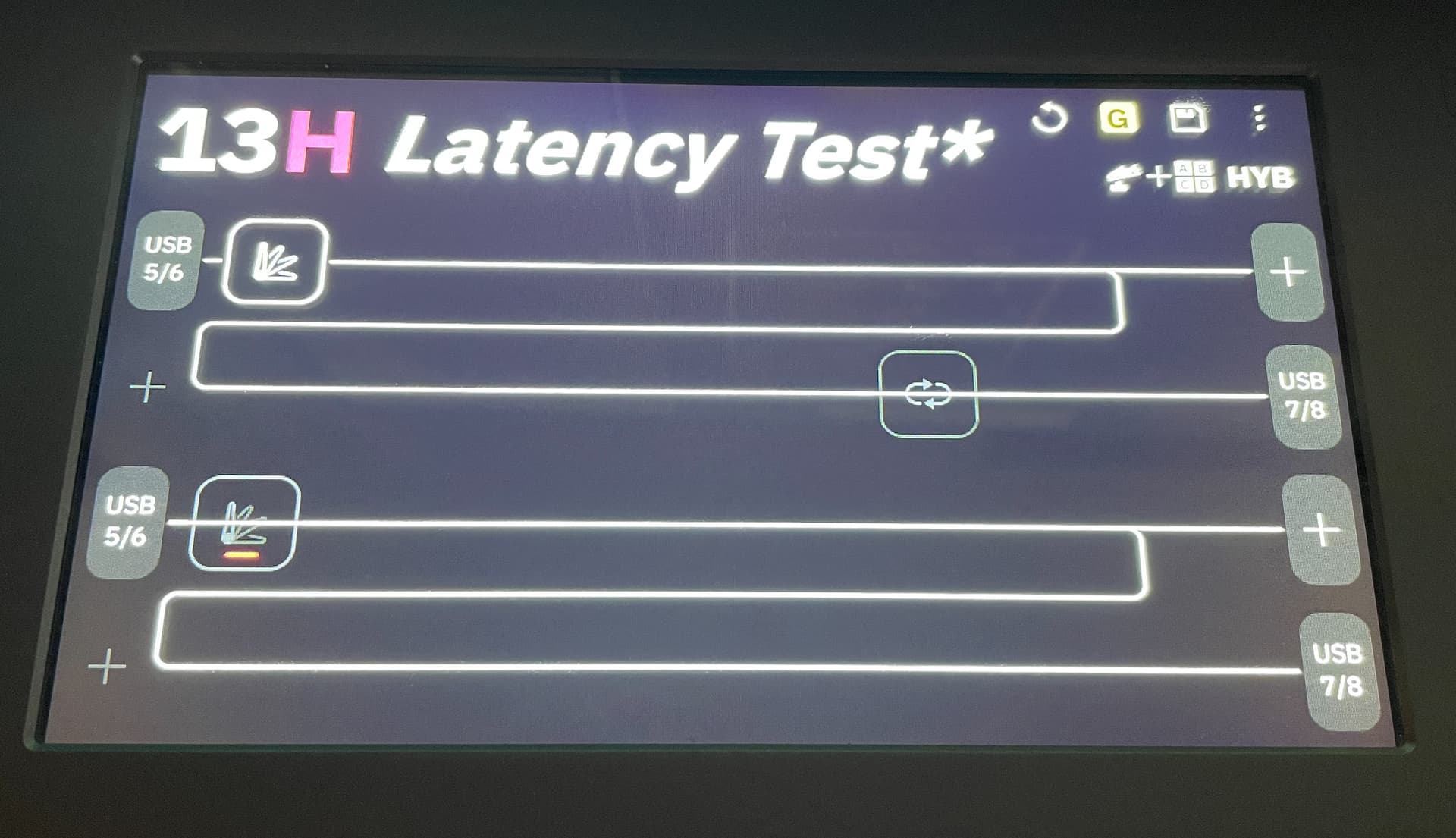

This isn’t changing anything, as soon as Row 3 is used in any ways, every signal gets a latency penalty. Even if you mute every block in Row 3 and just use the blocks in Row 1.
Ideally CPU1 and 2 should be completely separated (optionally) between Row 1/2 (CPU1) and Row 3/4 (CPU2) so that your idea actually works.
edit: your solution might actually work! Ha.
edit 2: there are still some caveats, using a FX Loop in Row3/4, for whatever reason, drags latency down on Row 1/2, even if the loop is not used there.
**edit3: This is bugged somehow. Putting the FX Loop in row 3/4 raises latency in Row 1/2 by almost 5ms (while not using it mind you), putting the FX loop in Row 1/2 only by around 1ms.
with the FX Loop in Row 2 i get 212samples of latency (4,4ms), dragging it in row 4, 429 samples (8,9ms) of latency using Row 1/2.
changing the FX loop with a simple cab, same thing happens. Staying in Row 1/2 I get 244samples of latency with a cab in row 4, while the cab in row 2 results in 212 samples of latency.
So you actually make row 1/2 worse latency wise with a block in row 3/4 even if you dont have any path going from row 1/2 to Row 3/4.
If you connect row 1/2 with row 3/4, you get a massive latecy penalty regardless of content in row 3/4.
its all very unintuitive. Latency monitor is badly needed.

Happy to run those tests.
I had actually begun compiling a spreadsheet of every amp/effect in every block and exactly how much latency it added by having it in the path. The results have been interesting…
