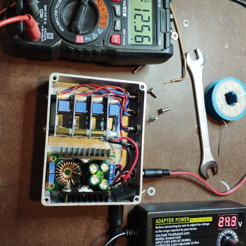

I now made my own power supply to use with my pedal board. I use a 24V-3A-Power-Supply and have a 5A-capable step-down converter for the QC. Thrown in a couple of smaller step-down-converters (5 pcs for 10€) to have power for other devices on the board. All outputs are adjustable…
the package gets only handwarm with no hum and noise, the most expensive was the hammond case.
