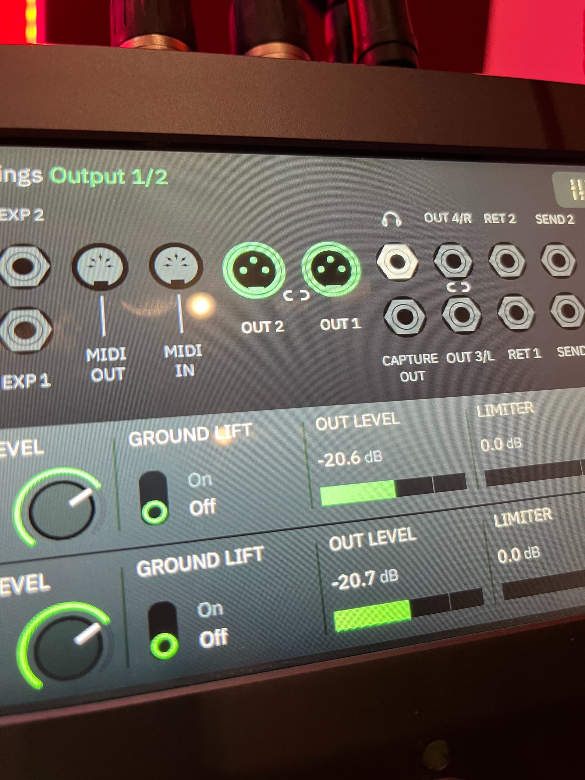

Also I can see the volume meter working on XLR out…but simply is not coming out.

Also the sound is coming from 3/4 and from headphones and on the controls seems that is not recognised anymore the XLR plugged in (are not white color) while if I plug a TRS it becomes white and works.

I have a similar issue, i’ve got connected XLR, sound go through but on the screen it shows grey connector, so that means that QC does not recognize that a cable is plugged in into out 1/2
