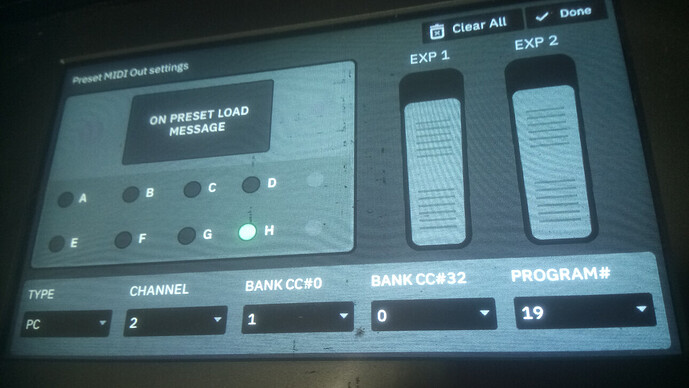

I am solving such a problem: I need my Neural DSP QC to switch via MIDI PC to
Roland GR-55.
In Program mode, I set MIDI CH=2 in MIDI (because the GR-55 works on this
channel) For each of the eight switches, I also set the MSB (1) and LSB (0)
parameters in the MIDI settings tab, because this is how it is on the GR-55.
And it should work (am I right???) that when each switch A to H is pressed, a
PG should be sent to the GR-55’s MIDI IN and it should switch to the appropriate
PG, but it doesn’t work
You don’t know me advise how to test it - break up.
I have a MIDI cable connected MIDI OUT with Neural to MIDI IN GR-55. I will
appreciate any help.

Riešim taký problém: Potrebujem aby mi Neural DSP QC prepínal cez MIDI PC na Roland GR-55.
V Program mode som si v MIDI nastavil MIDI CH=2 (pretože GR-55 funguje na tomto kanaly) Pre každy z osmich prepínačov som si v záložke MIDI settings tiež nastavil parametre MSB (1) a LSB (0), lebo takto je to na GR-55.
A malo by to fungovať tak (hovorím správne???), že po zošliapnutí každého prepínača A až H by sa mal odoslať PG na MIDI IN GR-55 a táto by sa mala prepnúť na príslušný PG, ale nefunguje to ![]()
Neviete mi poradiť, ako to otestovať - rozchodiť. MIDI kábel mám zapojený MIDI OUT s Neural do MIDI IN GR-55. Budem rád každej pomoci.
