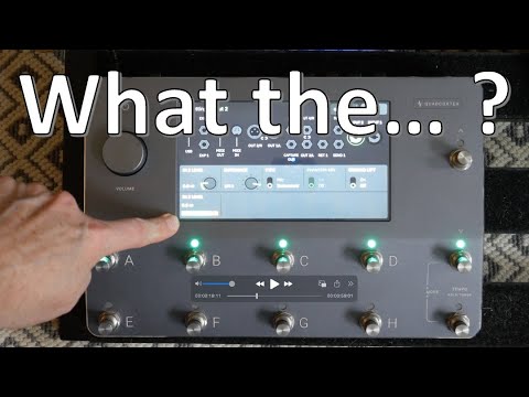

My Quad Cortex is behaving strangely - Anyone else had this happen?
My Quad is all messed up this morning. Getting some weird phantom input signals even without anything plugged in. Any thoughts/ideas?

As it happens I had been emailing NDSP Support for a few days before that gig, and one of the things they asked me was ā€˜is there any signal showing on the I/O page, when there is nothing plugged in’?
And the answer was yes, exactly like your video shows.
Interestingly as soon as I replied to say that yes, the I/O page shows multiple inputs are showing as clipping even with nothing plugged in, they immediately told me to return the QC to them for repair.
