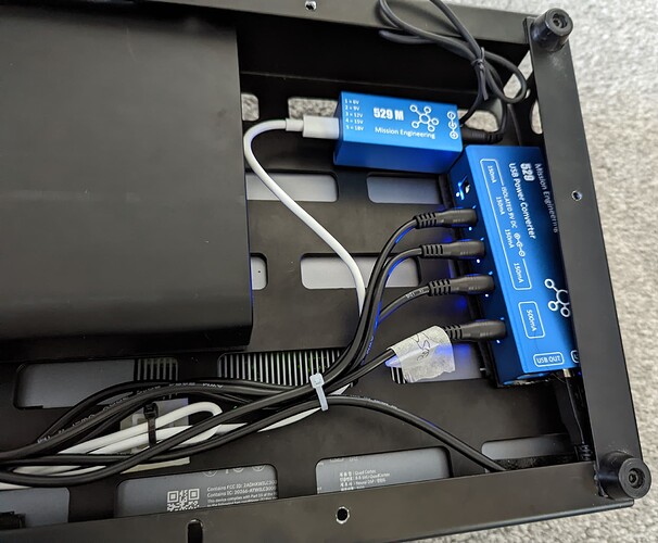

Updated my pedal board with a Redbeard honey badger fuzz/octave pedal ,
Also noticed I was getting a high pitched noise when using the boss wl-50 wireless transmitter so removed this and added a mission engineering 529 usb power converter for 4x 150mA and 1x 500mA 9volt connections.
Anyone else getting any noise from there wireless transmitter when using a battery for power, I think it’s ok when using power from the wall.
Also at the moment I have removed the two braces.
The battery is giving me I estimate 8 hours of use.

ups need to set the DC out to 12V 3 A. I guess you have to make the cable yourself if none of the supplied fit. You can also use usb out but then you need a mission engeneering 529m as in the images above
