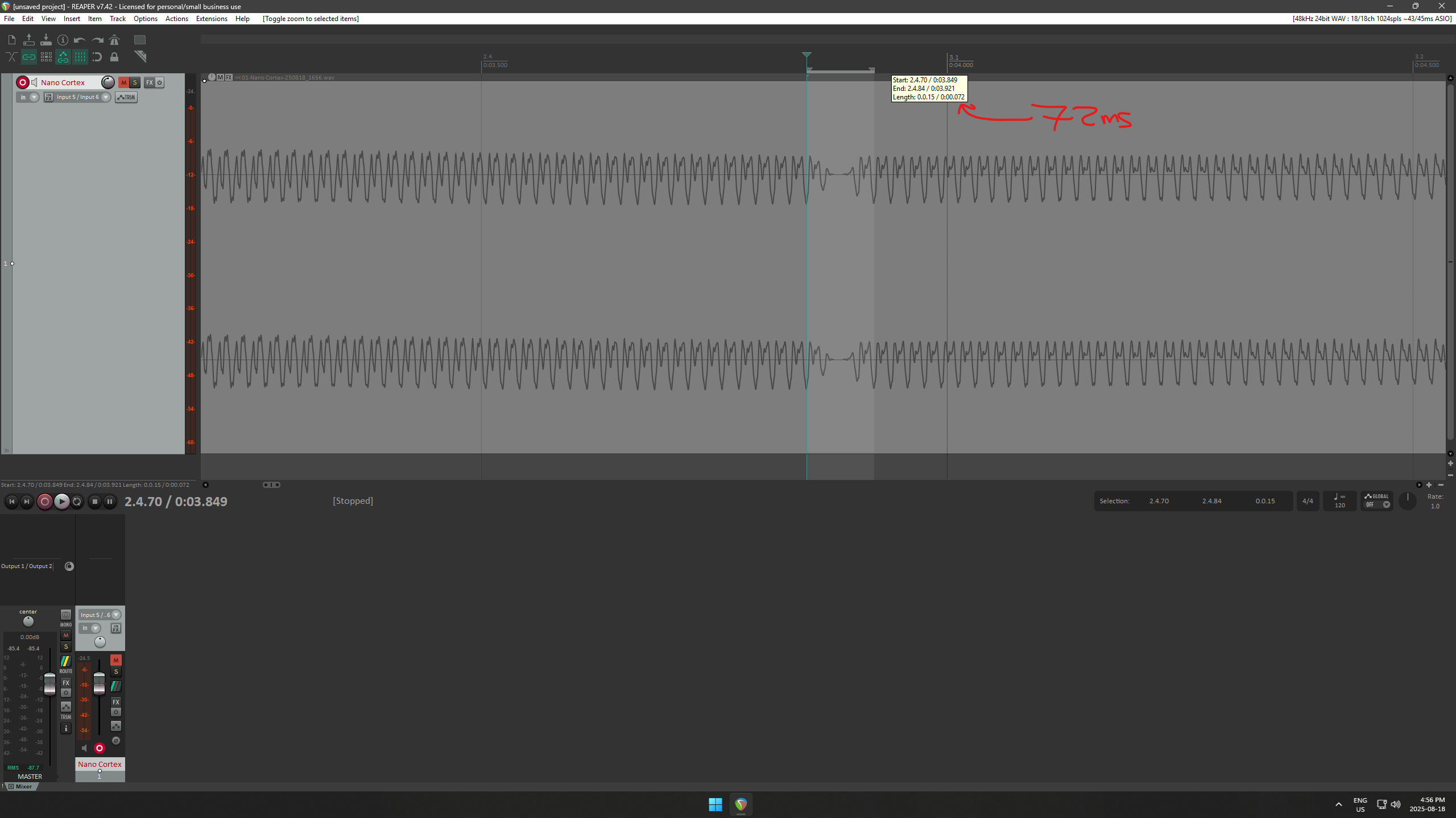

I’m looking for this as well. The 0.6 seconds silence made the pedal worthless for me.
To be clear the delay is 0.06s (60 milliseconds) according to NDSP not 0.6s (600 milliseconds)
It is definitely not 0.06 seconds. The gap is very noticeable.
60ms is a proper figure. This is switching presets in the middle of a bass note. At worst, from highest peak to peak, it is about 72 ms. I’m not saying it’s not noticeable, but NDSP is not lying to you.
