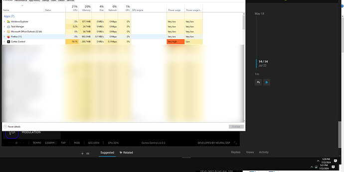

And it made zero difference re-installling it. I just uninstalled 1.0.0 and reinstalled 1.0.1 and same results. Here are the screen shots (only one per post allowed for me)
It’s a pretty serious CPU hit/glitch and It may sway me from being a neural user. 5 months is a really liong time for this. It sounds great, but it is a bit risky with the lack of support I have been reading about.
