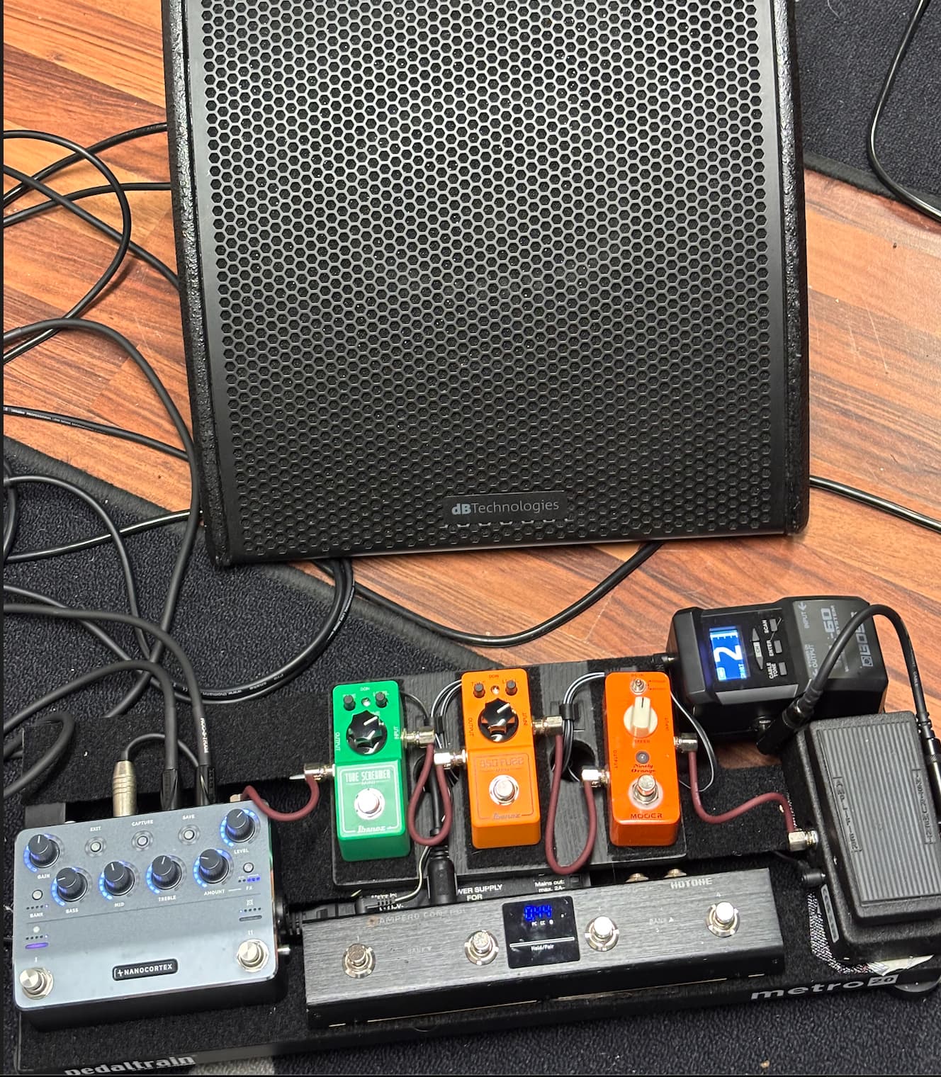

Im using Nano Cortex in my backup board ( made before the latest FW )
sadly I could not get ampero control to work with USB , using it via DIN to
turn effects on / off and select presets . I have used this live also for couple of times, no complaints there
Very nice and compact board.

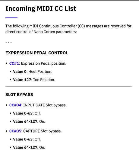

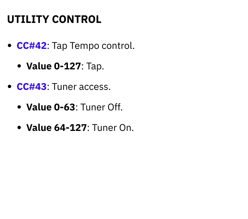

This changed with the last update. So you actually can use CC messages to turn on and off efx slots.
I know this. I’m only transcripting the message that helped me to make chocolate plus works. You can see the link and view all discussion about.
I actually guessed you knew this. I was actually wondering if you are using it.
It should work though right?
Yes. As I said it’s working for me.
