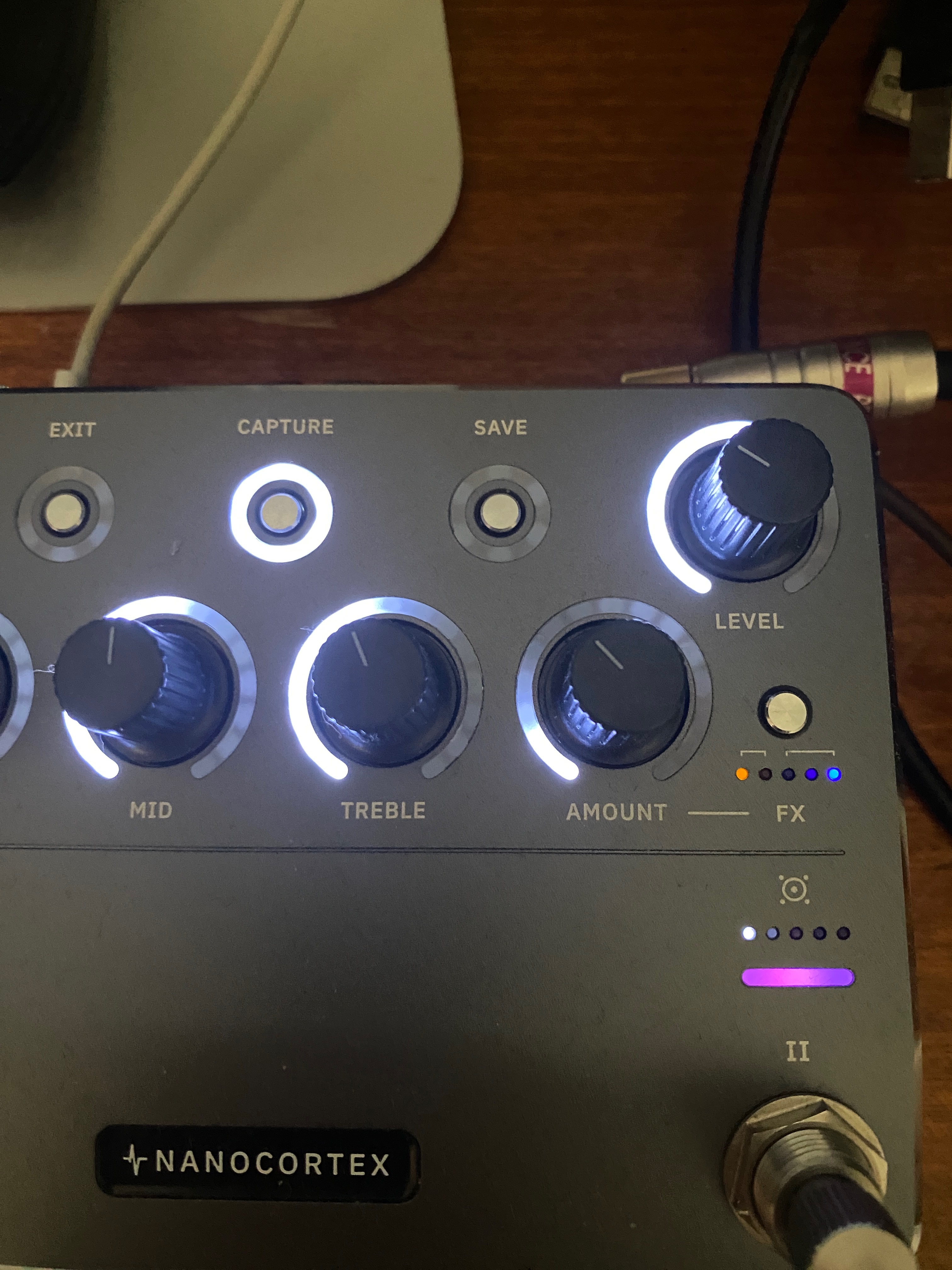

OK ! I have the explanation !
You have 2 solutions to sets level of presets individualy.
1: You can set LEVEL IR. I test with 10 presets using the same IR, if you change LEVEL in one preset, it not affect presets using the same IR.
2: You can set CAPTURE VOLUME. I test too with presets using the same capture, it works. I rectify my last post, you have to push 2s only CAPTURE button to enter in CAPTURE VOLUME MODE not “CAPTURE and SAVE” like I said before. Sorry for confusing.
When you are in this setting mode, you could see CAPTURE and LEVEL ring slowly flashing. Adjust like you want and SAVE. After this you have to EXIT to quit this mode !
I hope it’s clear.

Glad you corrected and let us know. I tried Capture + Save and nothing happened!
But holding Capture enters the ‘Capture Volume’ mode as you described. Great find!
I tried it and indeed you can see the ‘Capture Volume’ slider moving when turning the Level knob on the unit (when in this mode - Capture and Level flashing together).
