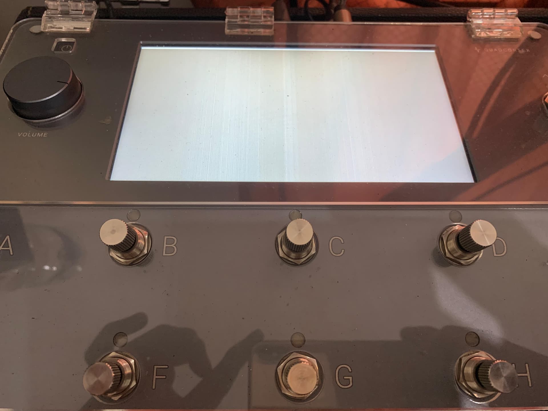

Touch screen nothing but lines

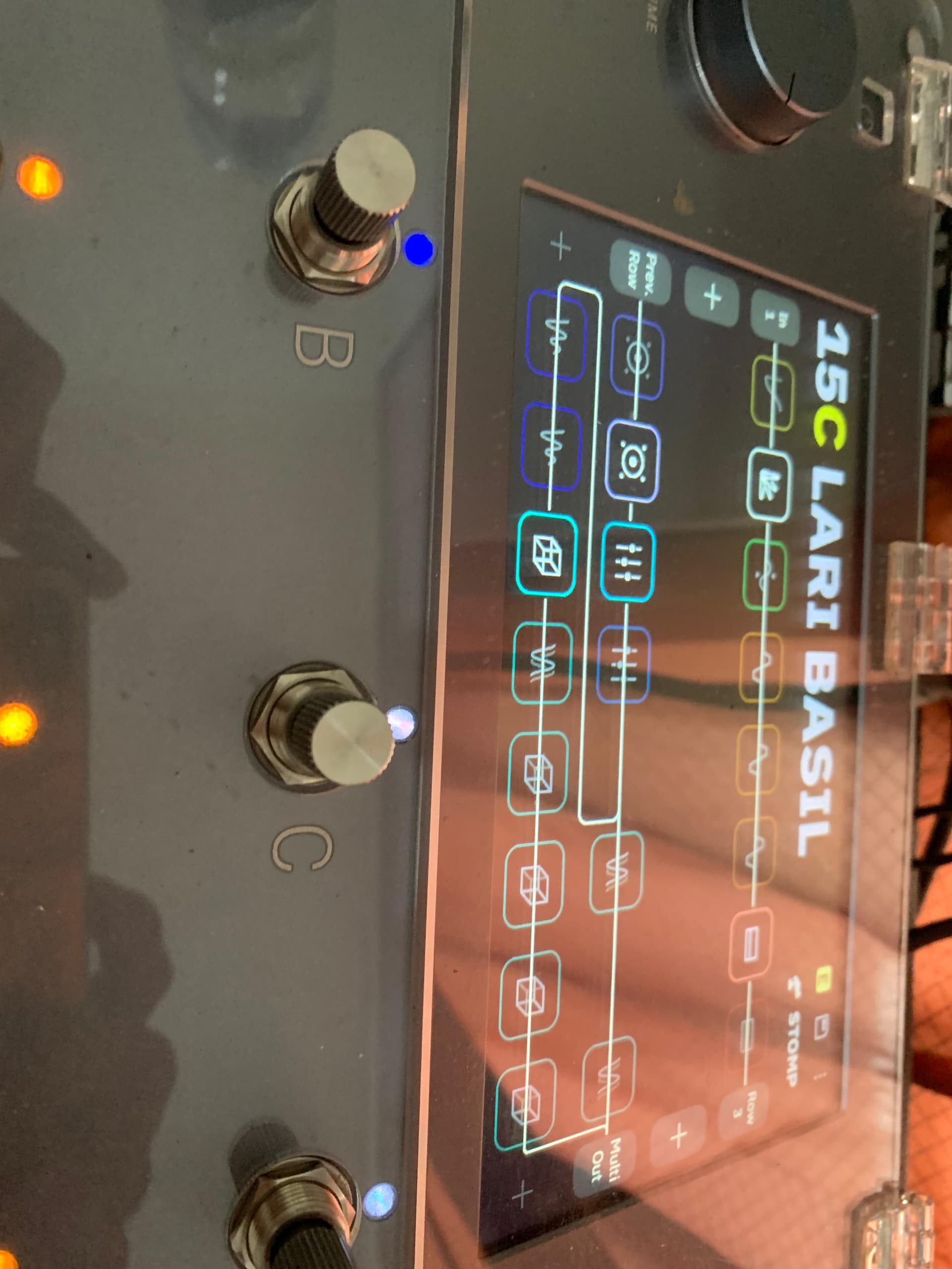

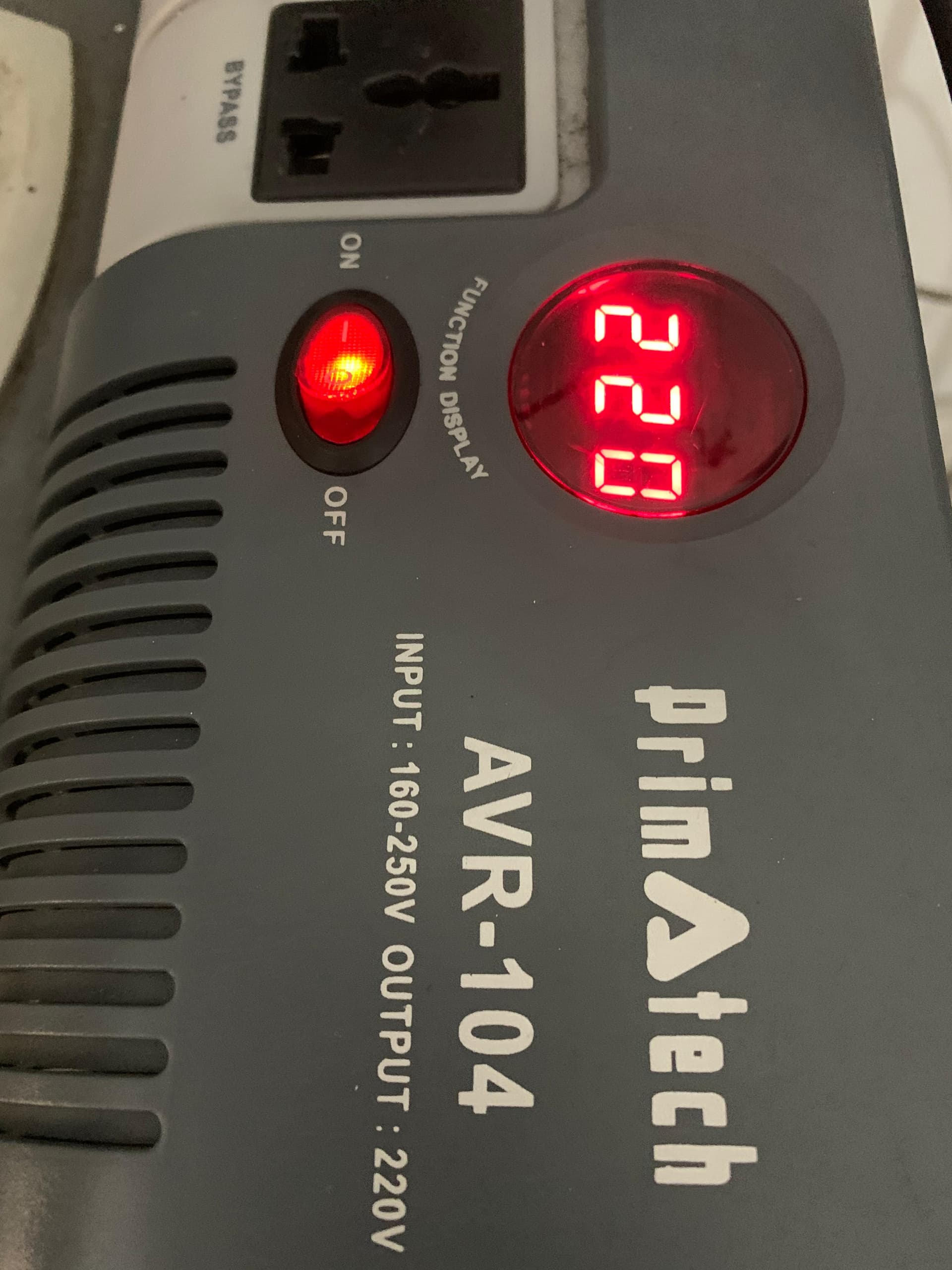

today i have this problem again, but i tried to use AVR Stabilizer and that problem gone, u guys can try, I hope this helps
from this
then i used AVR this one
And finally back normal
