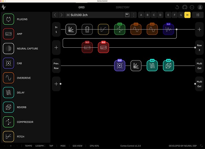

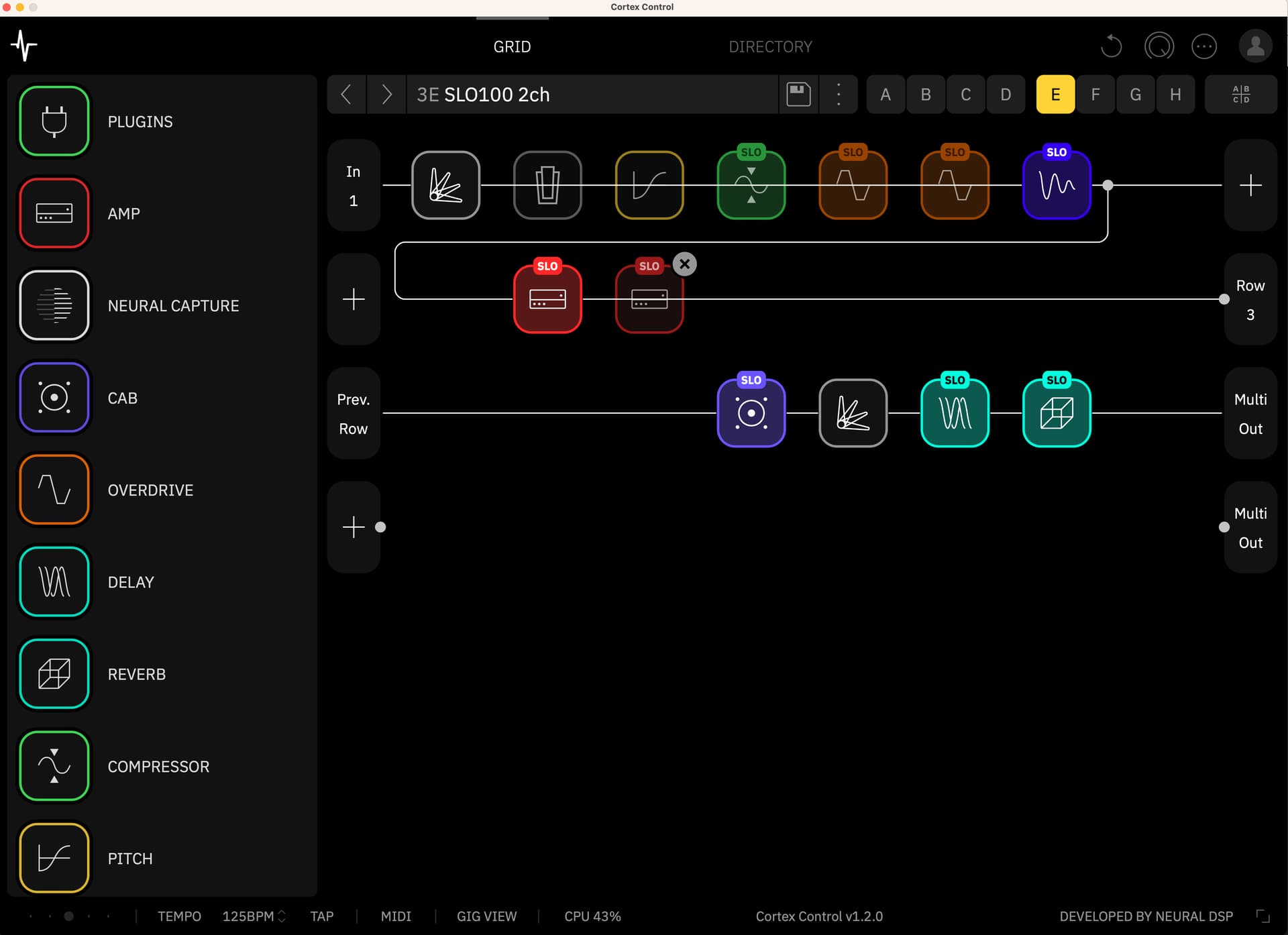

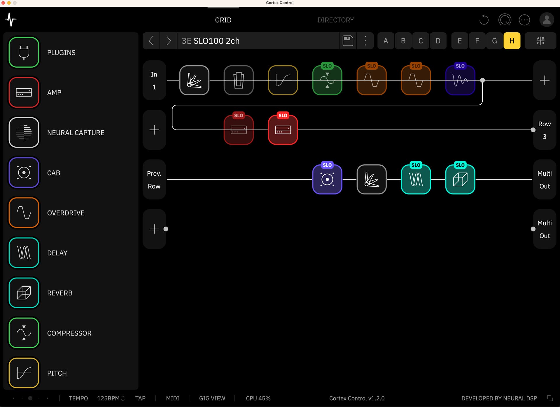

Here are screenshots of 2 scenes where scene E has a clean channel SLO100 active and scene H has an SLO100 with the OD channel on. I’ve tried switching channels using only one amp block, 2 blocks on the same row and 2 blocks placed on row 2 and 3 but there’s no difference. Please tell me if you see something wrong with this setup.
You’ll want to upload the actual preset to the cortex cloud so someone can try it. Hard to say just visually from the blocks. Switching channels on any of the single amp models on the QC has a gap, so we can ignore the possibility of that preset option. But that’s a pretty well known thing that’s existed for years now with various models.

Here is a screenshot of my ‘test’ preset. I’m tring some different things so don’t judge lol. I have three instances of the SLO. Two crunch amps in rows 1,2, ( one a little cleaner than the other ) and an OD in rows 3,4. I’ve had all three on rows 3,4 also with absolutely no noticeable delay with either setup switching amps with scenes.
Just by seeing your setup, I can’t see any reason you would be having trouble. The only difference visually is the way you have your splitter set. You may try returning the splitter to the same row ( if you haven’t already ) just to see if it could make a difference.

Can you double check that there’s no ‘scene assignment’ on the amp ‘knobs/switchs’ on the two SLO100 instances ?
It happened once for me with the JP2C amp, I copied the first block to a second slot in order to ‘instant switch’ between them byusing two scenes, but forgot that I previously assigned a scene to a switch that cause a small gap (those knob / switch usually have a small ‘i’ near them, indicating a ‘brief mute’ when switched).
I think I found the culprit.
On the second amp there is still a scene assignment for the channel. it changes between preset E and H. If you remove the scene assignment for channel the gap is gone.
For good measure you should also remove the scene assignments for crunch and bright, as they will also introduce that gap.
It works!!! Thank you all for the help! When I removed scene assignment from the OD amp the gap of silence disappeared. The only thing I wonder now is if the CPU can handle if I add a new amp block for every scene I want different amp settings on? I will try that later but for now I’m just happy that this works. Once again, thank you all for your input and time!
