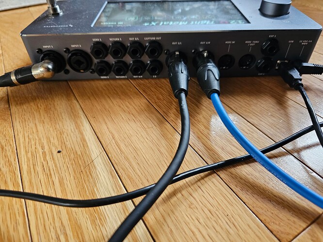

Do you have Global EQ applied? Also, just to confirm etc., it appears you are running both your OUT1/2 to your FRFR? Is it a stereo FRFR? If not, why are you running both outputs to a mono FRFR? Also, are you using the OEM power supply? I have seen output/volume issues when using the incorrect PS.
I tried plugging into both XLR of the speaker to see if it made a difference, it did not, still having the same issue with only one cable as well. I read that output volume could be affected by the power supply, I just never paid any attention to it as I have been using the one that came with the unit, but maybe there is something to it? Here is a picture of the PS
