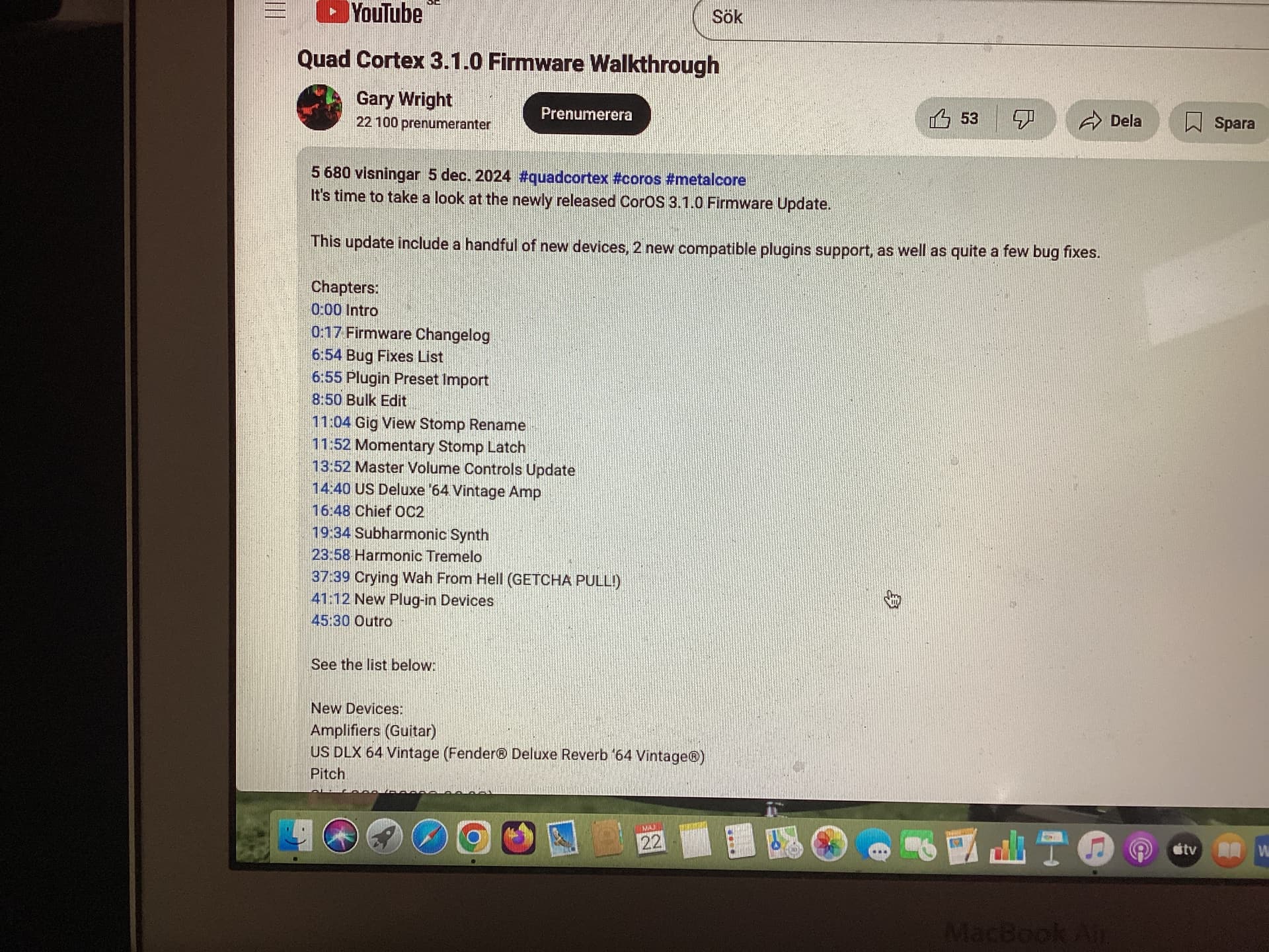

This is what i want, its only one new amp se picture below. I have only the quad cortex device, no pc editing.

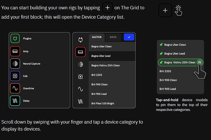

the picture I posted is from the manual and describes how to access the devices thru the Directory. Follow those instructions and you will find that amp he is talking about in the video.
This is all based on the QC itself, you do not need the PC-editor to access any of it.
Even though heās using the PC editor in the video, you can do all the same functions from the QC itself. Just watch what heās doing in the walk-through and repeat his steps on the QC to find the amp, if that is what you are asking for. You will have to make your own preset with it, there isnāt a Factory Preset for that particular amp (the US DLX 65 is not actually a new amp, itās an updated version of a previous model already on the QC)
tap an open space on Grid.
This opens the Device Category List
Press the Amp category Icon
*This should display all Amp Model choices. *
Scroll down till you see āUS DLX 65 reissueā or āUS DLX 64 Vintageā
tap that and it will insert it onto Grid for use.
