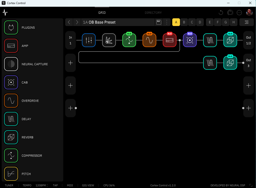

Im trying to set a preset that splits and sends Cab sim to XLR out 1&2, and no Cab sim to TRS out 3.. (I have made this work)
..But then I want the same Delay and Reverb at the end of both of these..
Currently, I am Just adding Duplicates of the Delay and Reverb and I can do this with the stock DLY and RVB
But I am out of DSP when I try to use DLY and RVB from Plugins like Gojira or SLO100.. and can’t add the 2nd RVB..
Even routing the signal from Path 1 → Path 3..
This should use all the DSP available?
So If Path 1 is doing all the heavy processing in this preset, why can Path 3 not handle 4 effects?

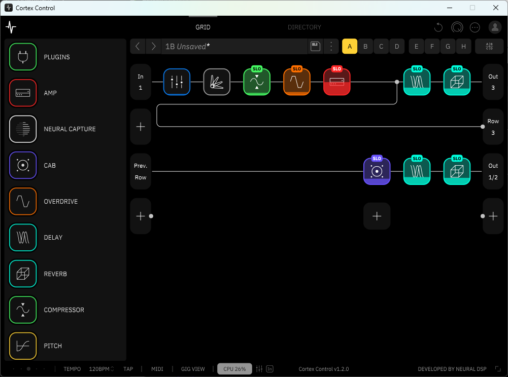

This was my original attempt and it works with stock DLY and plugin RVB, but the plugin versions are too DSP heavy to use all 4 plugin versions I guess…

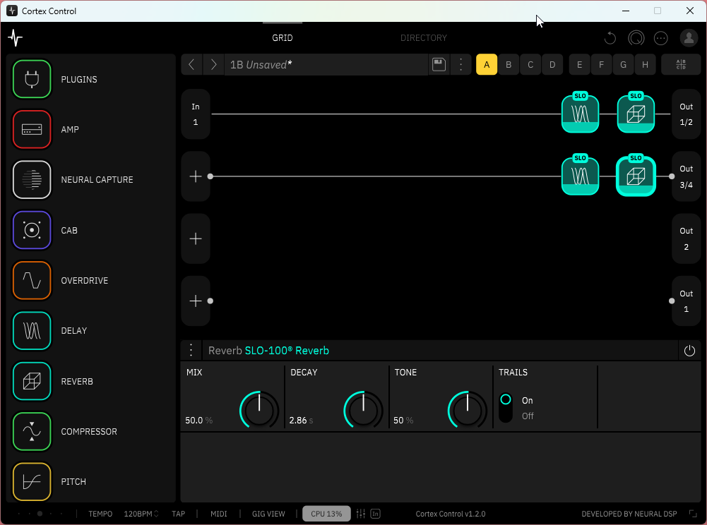

For example when I put only the SLO reverbs and SLO delays on rows 1/2 they use 13% CPU.

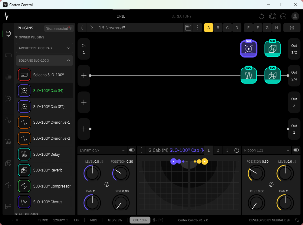

When I replace one of the delays with the SLO Cab (Mono) it’s also at 13% CPU.
You can see that all blocks use roughly the same DSP about 3-4%. So DSP-wise there should be lots of room.

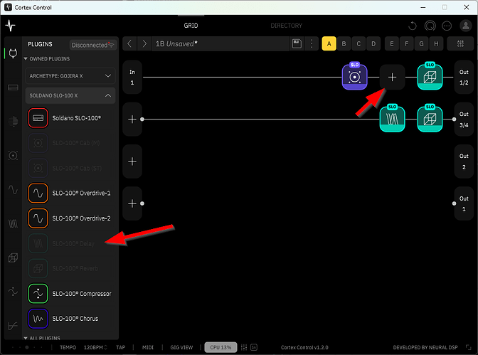

But if I try to add the SLO Delay block back in, the delays, reverbs and cabs aren’t available (other SLO blocks work).
You could send this to support@neuraldsp.com and see what they say.
I can’t remember that they said anything about a limit for the number of plugin blocks you can place, so maybe it’s a bug.
As a workaround you could do something like this to split the delays/cabs over the two DSP cores:
That last pic looks like it will be the answer. I really appreciate it! I’ll send it to Neural also as you suggested.
