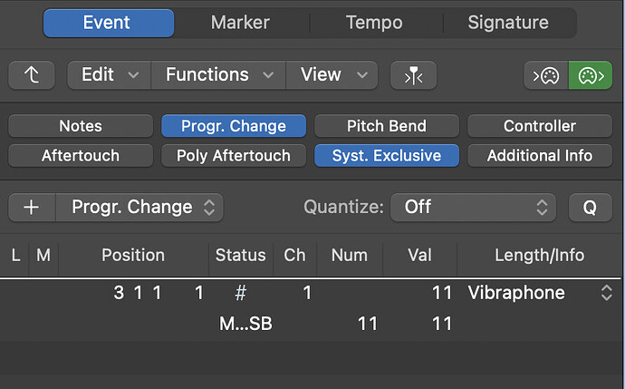

This is what I have on Logic Pro - and I click on the + button for program changes (not 100% sure if this is correct or not) - but it does actually work and changes my QC presets. However, what I wish to know is how does the following numbers relate to the Logic Pro event numbers please???

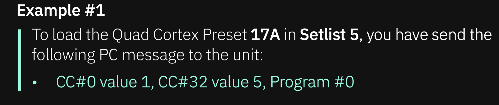

So when I want to make a change to cc#0 value, why do I not see a field for that in Logic. The same with cc#32 etc. It is very very hit and miss at this stage. I would just love a simple way to be able to map all of the values shown in the QC manual into Logic etc.

In principle, a program change message consists of MSB, LSB and PC.
In the MSB you put 0 for presets 0-127 or 1 for 128 to 256.
Then the LSB is the set list (0-12).
And PC the preset (0 - 127).

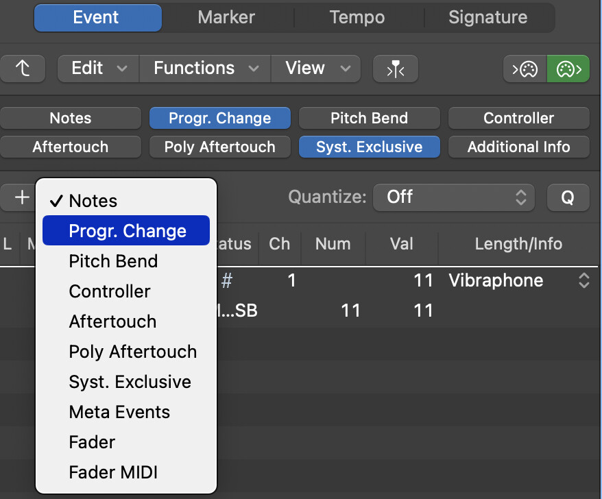

If you want to send CC messages, I guess you need to select “Control Change” instead of “Prog. Change” before hitting the + icon.
Thanks, but there isn’t actually a Control Change option in the list.

“Controller” is the one which sends CC messages. Where it says “length/info” you can select the CC number.
And assign a value in “Val”.

The confusing part is that in Logic, the Program change message allows you to set a preset (field “Val”) and a MSB (in the line M…SB), field “num”.
But it does not include a LSB for whatever reason. So to select your setlist, you need to send a CC to CC32.

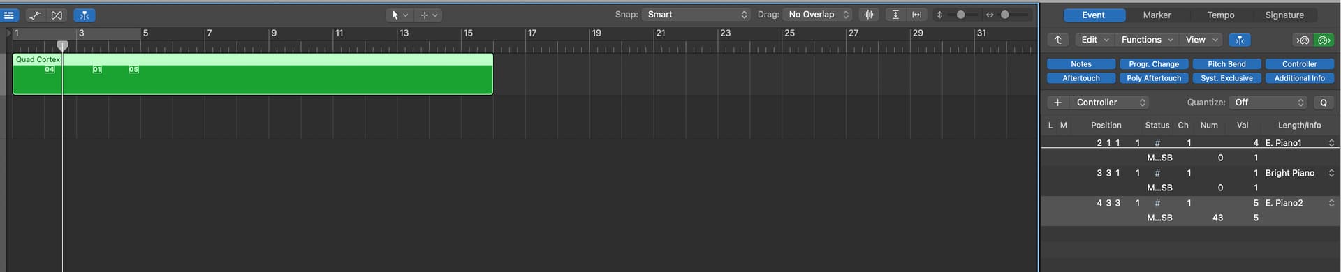

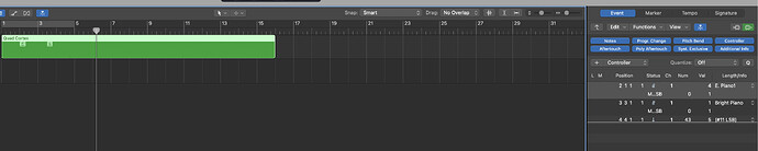

This is where I got…
I have 3 midi events in. They change the patch as needed. The third one was an attempt at changing the scene CC#43 to Scene E (5) but it didn’t work - it just changed to another unused preset.
Yes, 0 or 1 seems to work for the patches alright i.e. 0-127 and then 128-256. I am going to try your other suggestions now, hopefully they will work and that will be everything then. Thanks again for your help with this.
Regards.
Ian.
OMG that worked!!!
Thank you so much.
It appears as an event in the event list but not as an entry in the MIDI Region - but I don’t care about that. The functionality is working which is AMAZING… Thank you…
