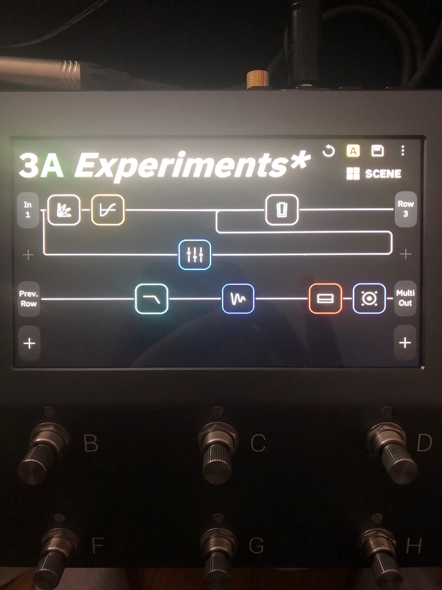

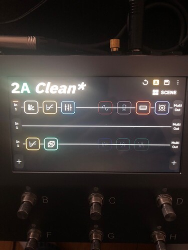

I find it doesn’t work for me as it isn’t running correctly, and I have a worbble. I have added it to the 3rd row (two now) to see if that row need it too, and it still does. I suppose it is my structure of rows.

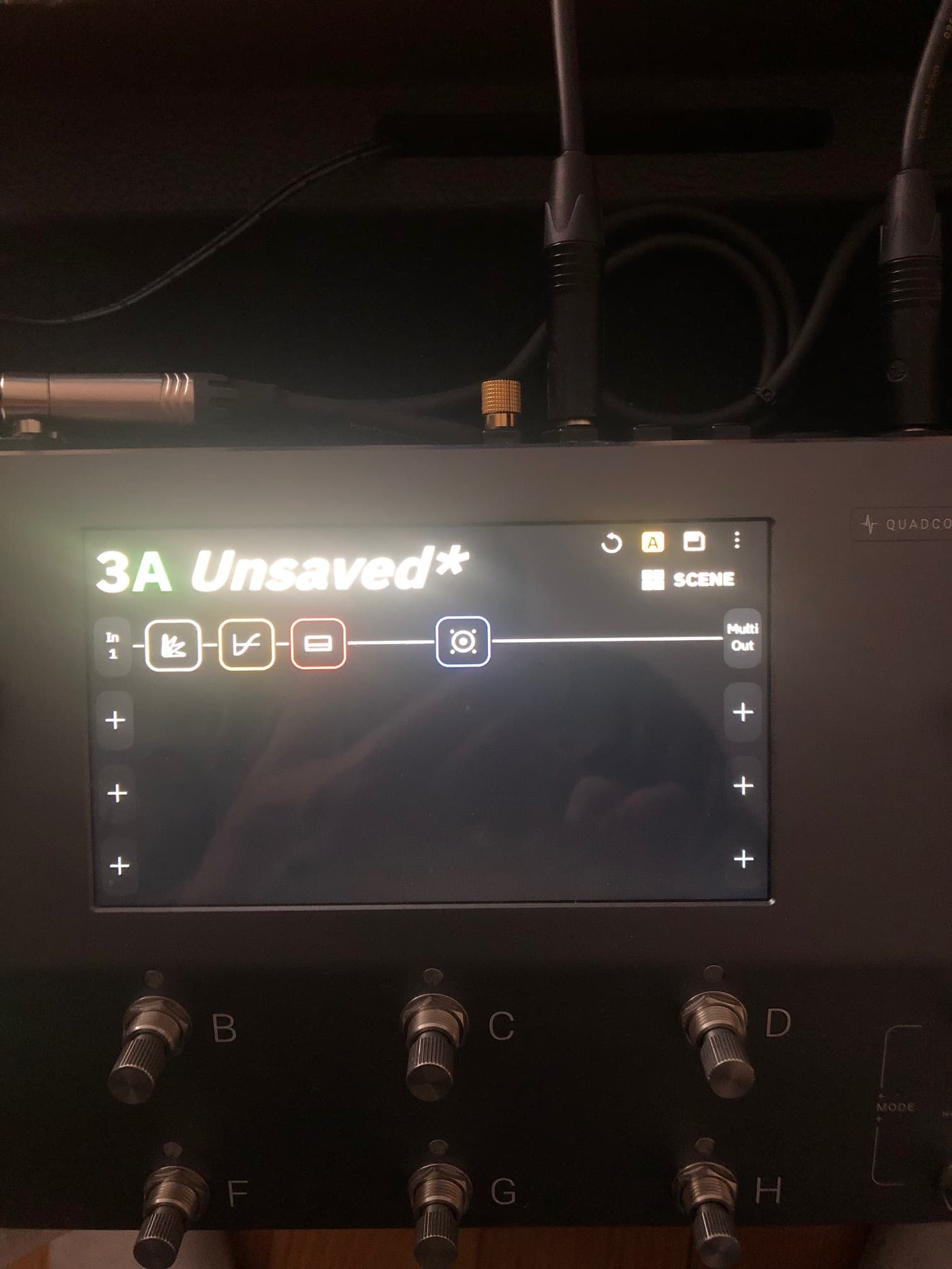

I created a scene with only noise gate, pitch shift, amp then a cab, It works. BUT I need to understand why I am not getting the results with adding it to the front of my current scenes.

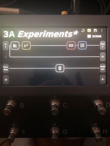

I did edit this to include an experiment picture. I have never made rows connected (I am a nuboo still) and I think I am on the right “path” so to speak. Is this a way to solve? I SURE do NOT want the wah etc. after the amp lol BUT I am just starting to move rows and don’t know how.
Have I run my “rows” incorrectly? I see many with a connected chain drop down move in the signal paths. Please advise. Thank you. I have a few pictures included to help to explain. It still is nasty bad sounding even in the last instance when I turn off all the other things even with a loop and changed row routing.
