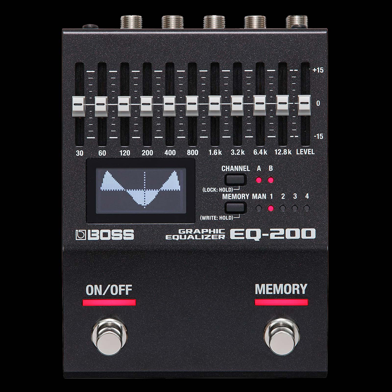

Boss EQ-200 is a stereo equalizer with presets. I think this would be ideal for what you’re describing you want to do. Check it out.
Thank you for this. I will check it out.

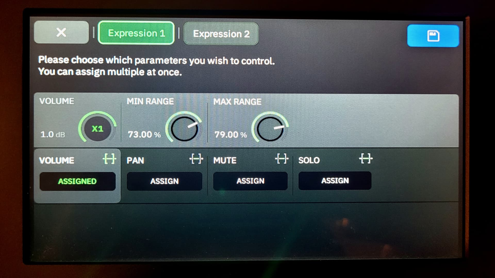

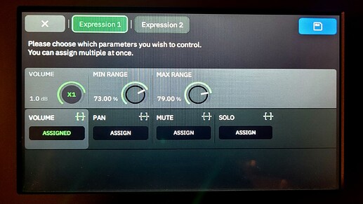

It is possible to use an expression pedal directly on the output, but you would need to be extremely careful setting the minimum and maximum values so that it doesn’t push a huge amount past unity gain. Here in this example I set up an expression pedal from -2 dB to +1 dB; notice how the min and max values are 73% to 79%.
I should also mention, that you would need to set this up per preset.
There is the Solo output function, don’t know what it does because I never use it and I forgot to play around with it when I took the photo above.
