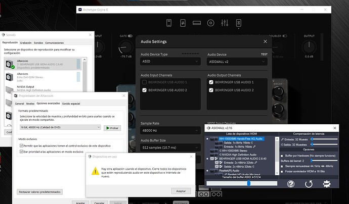

Hi, i’m trying to play with a backing track but I can only listen the guitar through my headphones connected to my UM2 interpfase, but the sound of the backing track doesn’t play or plays through the laptop.
I’ve followed some instructions from previous posts that said that I just needed the sample rate from both the plugin and windows be the same but it isn’t working for me, or I’m not sure if what I’m doing is right.

Make sure in your windows sound settings it is set to the behringer main outs 1/2…
asio4all isn’t a great asio driver..
I’d recommend the umc 202hd since it comes with a driver built for the interface…
Your windows sound setting should be set to asio4all and so should the ndsp plugin and make sure they are the same samplerate.. And try bringing your buffer size down to 128 as a maximum setting
