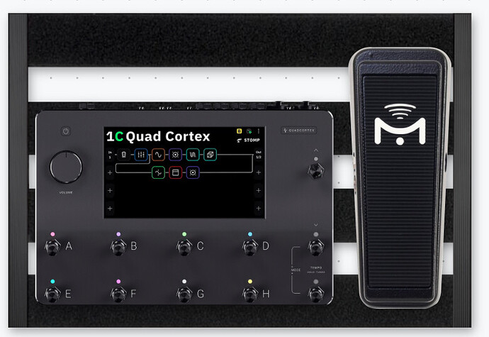

I’ll mount just QC and a GLXD16, that’s why I’m also considering saving some money, buying a plain pedalboard and using just a power strip maybe to be fixed under the board → any concern/advice about this?
I would trust the setup more than whatever the Harley Benton power supply is tbh
