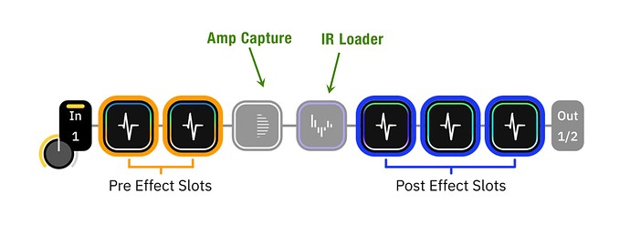

How about disabling the IR Loader and use an EQ in the first post fx slot? The “Low-High Cut” eq has very similar controls as the IR Loader eq and gain section.

The signal chain on the Nano Cortex has 5 effect slots. 2 pre and 3 post. So you can have eq in the first post effect slot directly after the amp capture slot.
ABSOLUTELY! How the h@#$ did I miss that. Maybe because I’m part human part buffoon sometimes. This is what I was looking for. Serves me right for not RTFM……..
