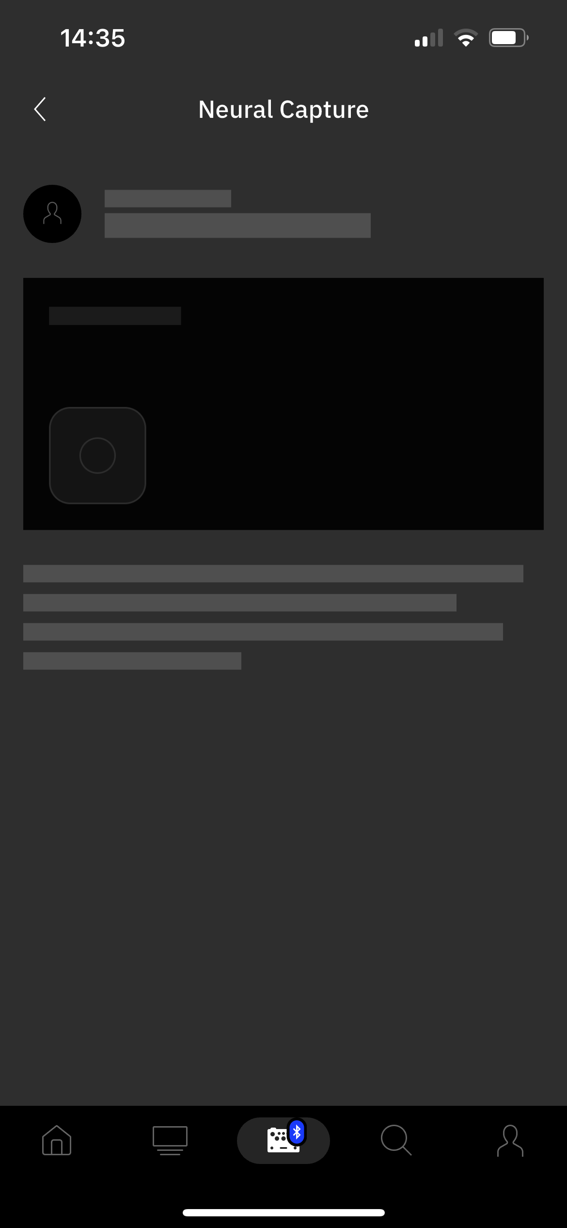

Second issue, when it does keep connected for more than 10 sec, I go fast to make a preset, everything works except ONE thing : Neural Capture. I can’t setup amps, it keeps on a “loading” screen, I can wait a long time nothing happens, not a single knob to setup gain volume etc.

Yes, V2. I also downloaded Neural Captures from other users, and sometimes there is a “details” page sometimes not, with amp description and a picture of it. If it’s only a description and hashtags and a photo, I don’t care tbh, I’m more worried with connexion.
