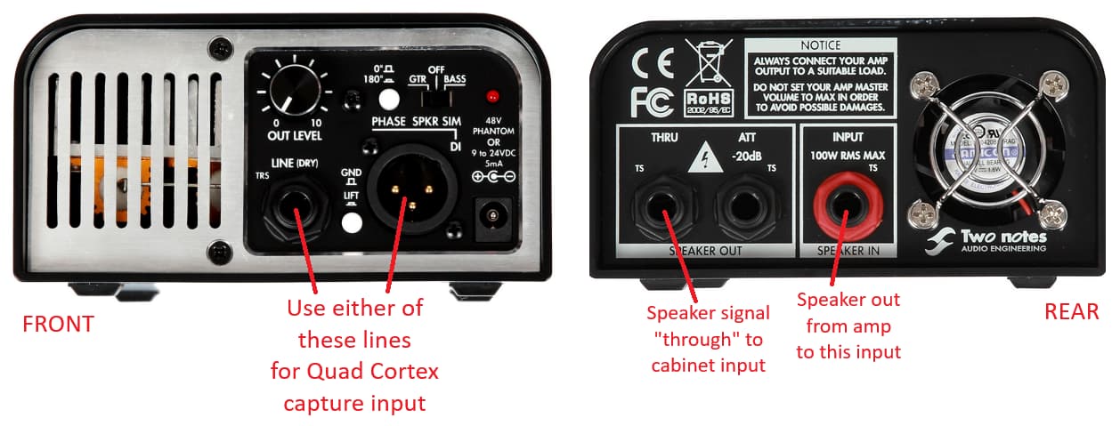

Im trying to figure out the best way to capture amp heads without a cab at all. Basically I want go out from the amp head to some sort of box (loadbox?) then out of the that box, whatever that may be, directly to the quad cortex and use the included IR to play through the amp and figure out my settings before capturing it. Would this work with the Two Notes Torpedo Captor Reactive Loadbox DI and Attenuator or would I break something. Any recs?

The Captor itself is a load box and does not need to be hooked up to a speaker cabinet in order to get the line out to work (to go the QC’s capture input), but many people who have used it for captures claim that they get better results if the speaker “through” outputs are connected to a cabinet.

As stated the TwoNotes load boxes are the absolute best without having any cab. I had a Revv G20 which had one built in and it was excellent.

Two notes is great. The Captor is probably the cheapest way in.
