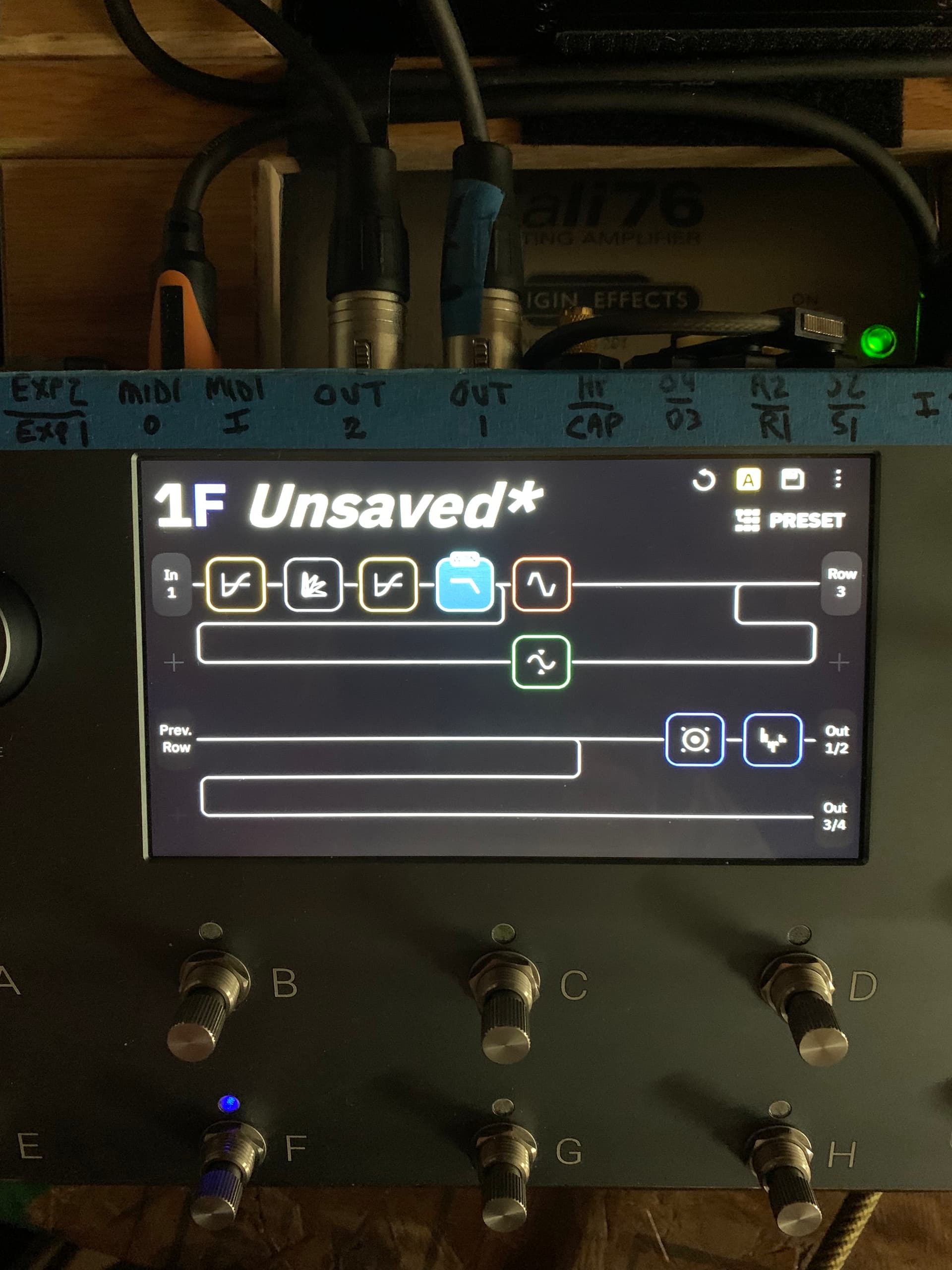

Simple answer… yes.
Preset created using your road map. IMO the most underrated function of the qc is its digital routing capabilities. For real!!! Ignore cabling. Pic taken from my board.
