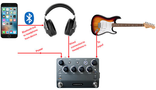

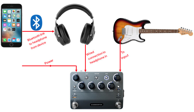

But since you stated that you want to play on headphones, you’d be looking for a pair of headphones that can mix the audio from the NC via wired connection to the headphone in, along with Bluetooth simultaneously (which would sync to your source audio device i.e. your phone playing a backing track). Here’s an idea of the ‘chain’ so to speak:
So if your headphones have this capability, awesome. If not, there’s plenty of headphone options available of varying quality, that can simultaneously do a bluetooth connection and plug directly in. Google is your friend, and I hope this helps!

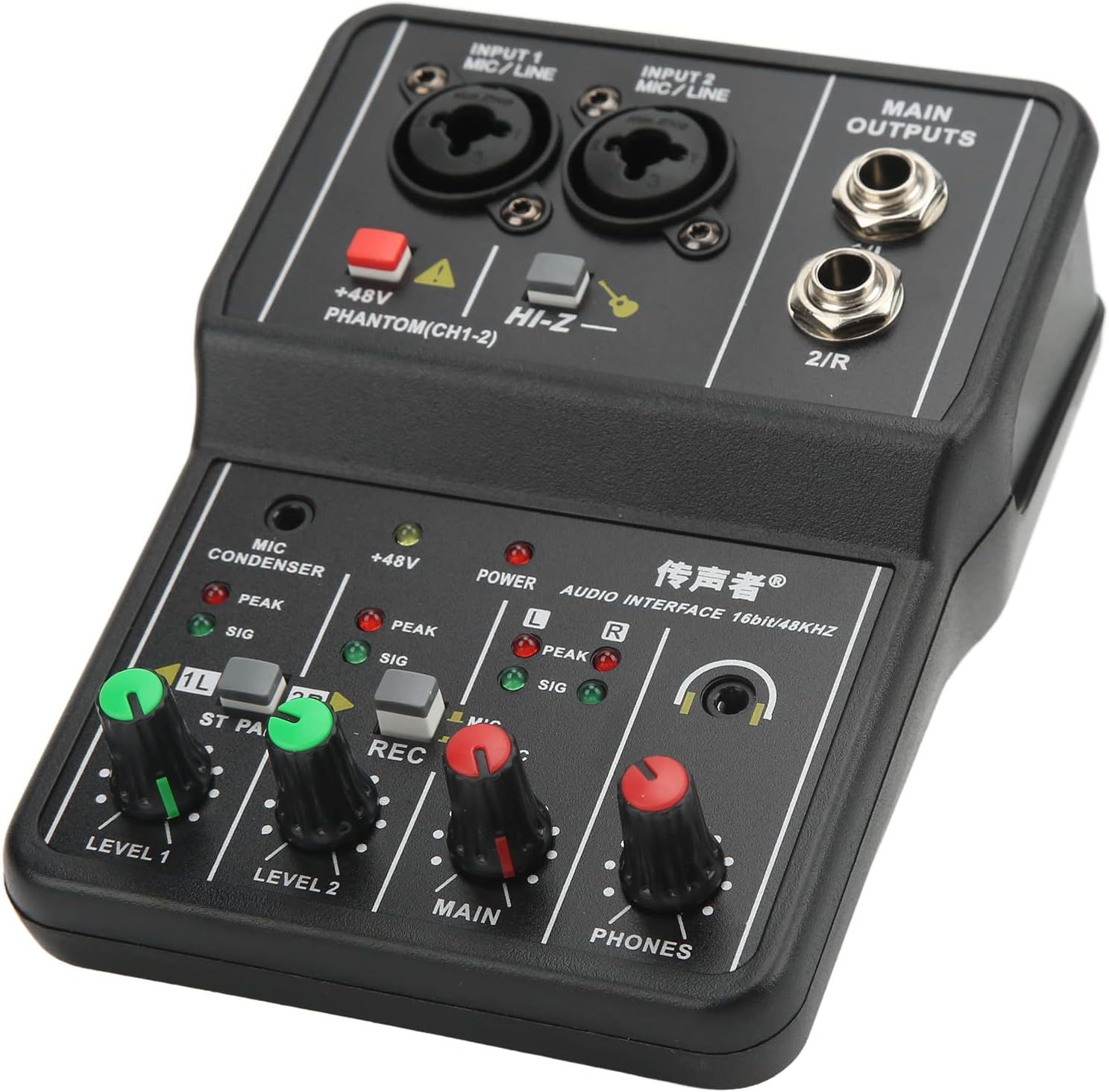

I have a cheap 40$CAD two channel mixer with a headphones output and aux input. Allows me to play along with backing tracks. I use a Bluetooth speaker when I use an amp though
Feel free to add a link for those interested. Thanks!

Here ya go:

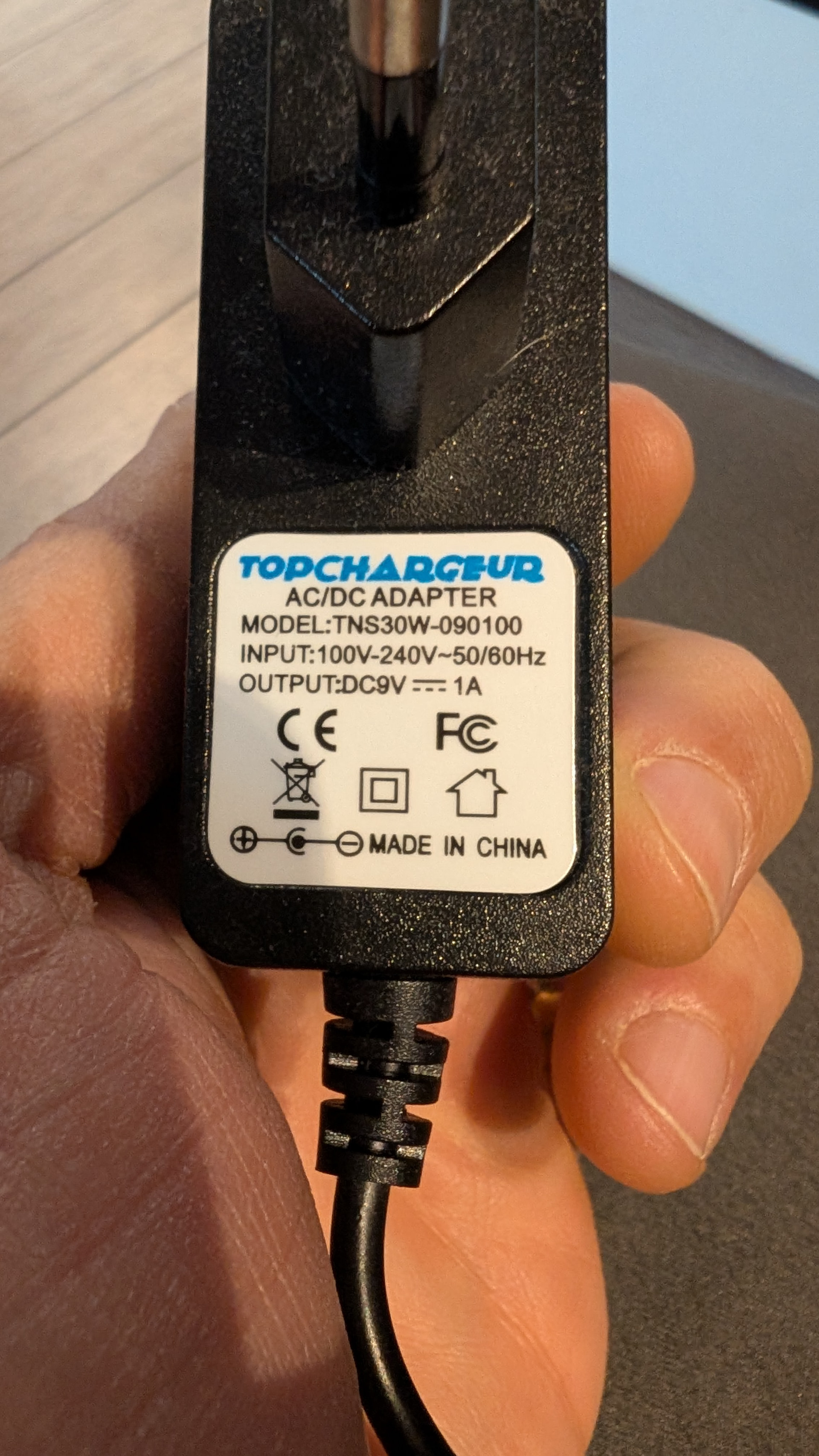

I bought a 9v charger to free the USB-C port and tried this way linking the android phone. It wors but…. randomly the backing track starts to distorts randomly. I made some experiments, changing the usb-c cable, moving it, switching from local mp3 on the phone to youtube backing track but discovered nothing. I even tried with an iPhone but the iphone doesn’t work at all, don’t know why.
I will make other attempts as soon as possible, but if it works I think it is better than having another piece like an external mixer or special headphones.

That is really Strange. Did you try to lower your input for the usb sound in the app? Maybe something is wrong there. I did this extensively with my iPhone and never had a problem.
Maybe another usbc cable.
What IPhone did you use?
