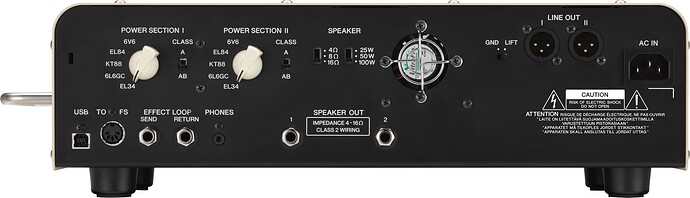

Can someone help me with how to correctly cable this?

I know I have to connect to the effects loops send / return on the back of the Yamaha THR100HD amp, but what will change in my current cabling?
Image of the back of the amp for reference:
‘Best practice’ would probably be guitar (+pedals) into focusrite into NDSP, then out to the FX loop return to avoid doubling up preamps and the noise that will involve.
You’ll lose out on ‘true’ stereo like that though (unless the FX loop is stereo?). If you’re confident you can flatten the EQ of the yamaha’s preamp, and are careful with gain staging, you could run a stereo signal out of NDSP and into the two front inputs, to take advantage of the stereo delay.
At the end of the day “if it sounds good, it is good.” If you’re not getting loads of noise (and with tone king I guess you’re not chasing high gain…?), I’d imagine it’ll sound sick.
The routing you described probably isn’t ideal. The amp is going to impart its own tone controls onto the signal before it hits the Tone King plug-in.
Honestly, though, if you truly want/need stereo and only want to hear the plug-in (not tone controls from the Yamaha amp), then I would suggest a stereo power amp.
^^^ I have tried this with my setup (except I run mono signal into an Orange Pedal Baby and 4x12 cab) and it works great.
That’s what I meant by this:
But also
As long as the gain is under control, it’s just a post-amp EQ. It won’t be a faithful representation of the presets, but what does that matter if it sounds good? Obviosly if you need a crystal clear stereo amp, you’ll have to buy different gear, but I assume that’s not the idea here…
