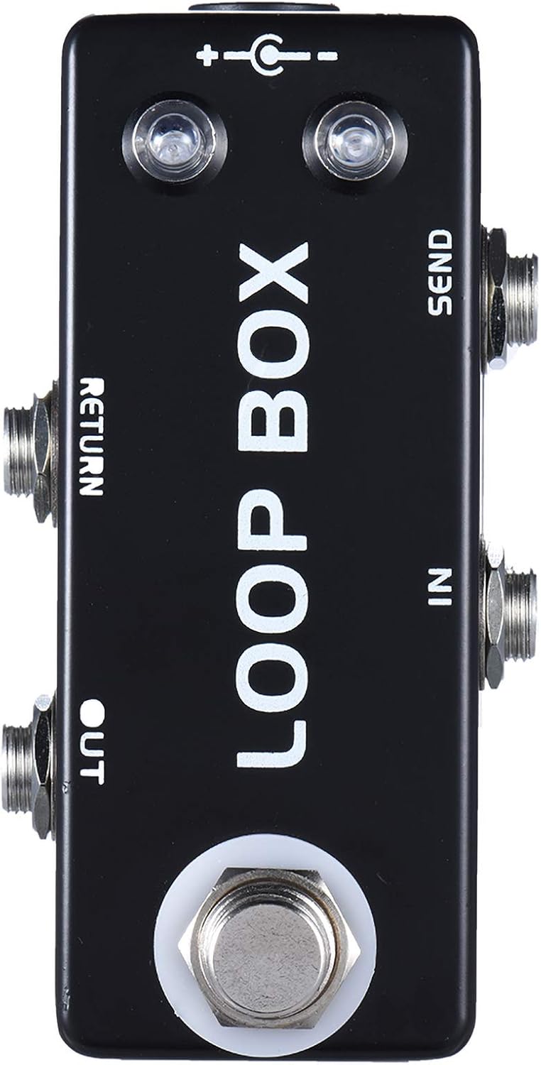

A bypass looper pedal would work, put the whole QC into it, and switch in and out
I’d say a Keeley but they are discontinued
Maybe this:
