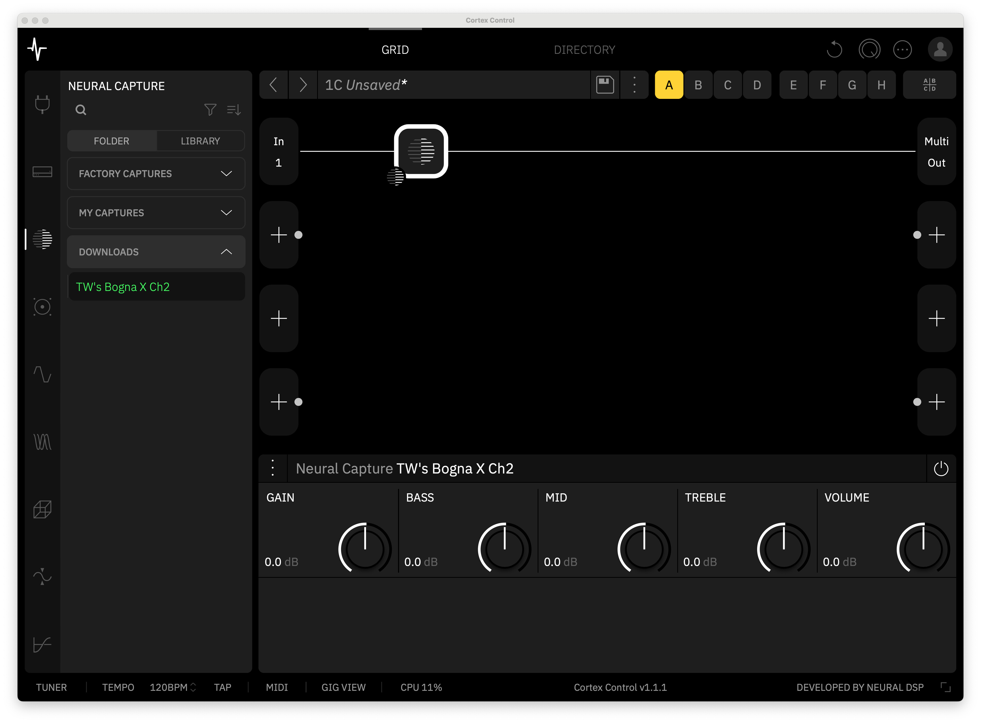

Well, I don’t get the dots to the right of the name of the downloaded capture. I don’t know how to delete a capture from Cortex Control.
Select ‘MY CAPTURES’ and delete the applicable captures.
The MY CAPTURES folder is empty, as I haven’t taken any screenshots yet. I’m referring to the screenshots downloaded from the Cortex cloud. In the image I uploaded it is TW’s Bogna X Ch2 which is in green.

Go to directory and then to the captures. (You‘re in the grid view
