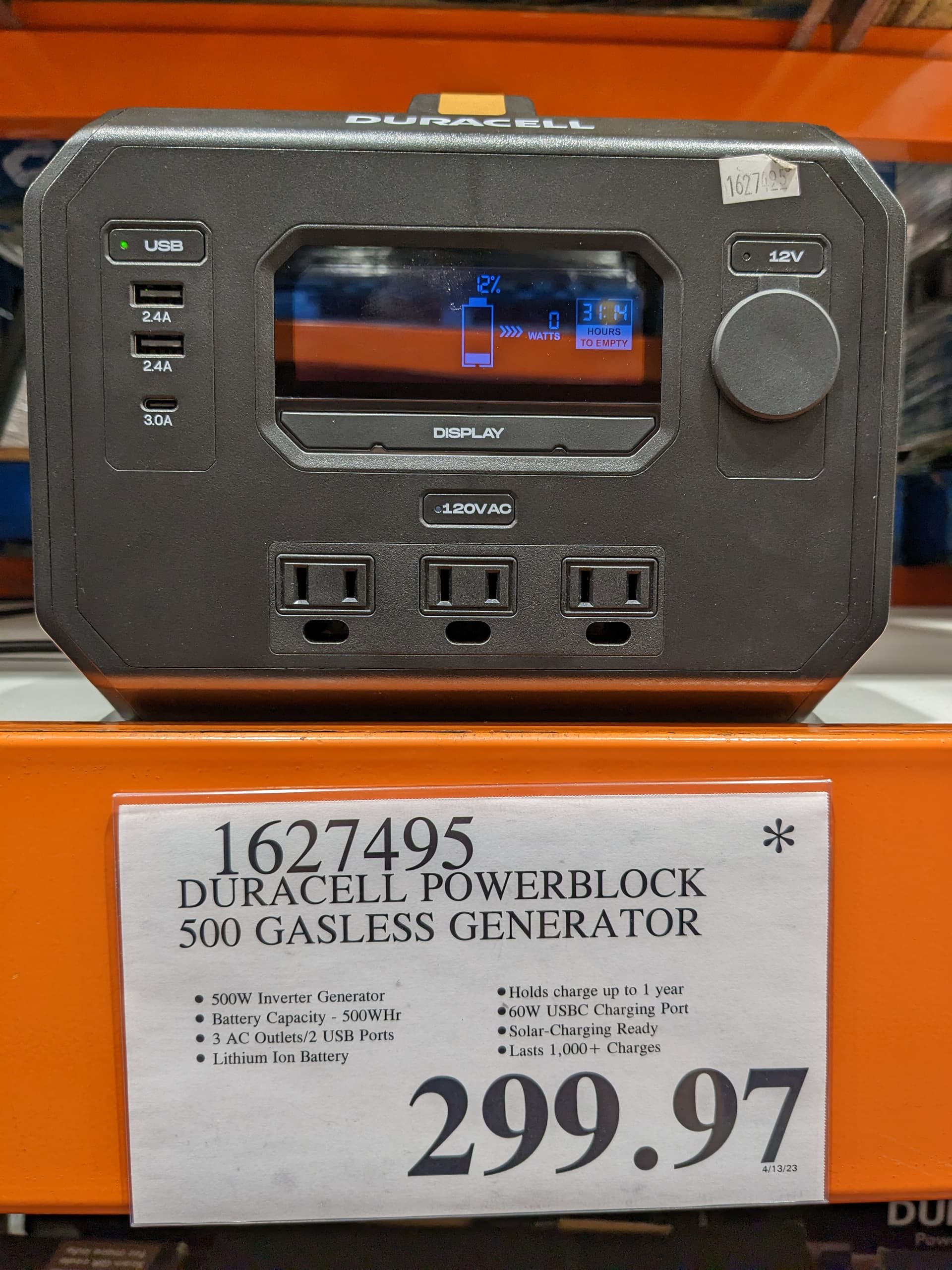

Here is unit being sold at Costco (at least in the US) that is a dream solution for those who want/need to free themselves from the wall sockets. It can even be recharged by solar panels. Perfect for that gig in the park or at the beach.
