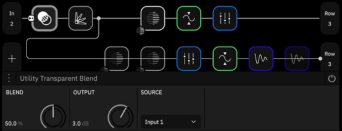

Why not use the Transparent Blend block to insert Input 2 to your signal path? Then you can switch inputs with its blend.
This also saves an entire lane that would’ve been used for the second input

Agreed, Transparent Blend is the ideal way to handle this.

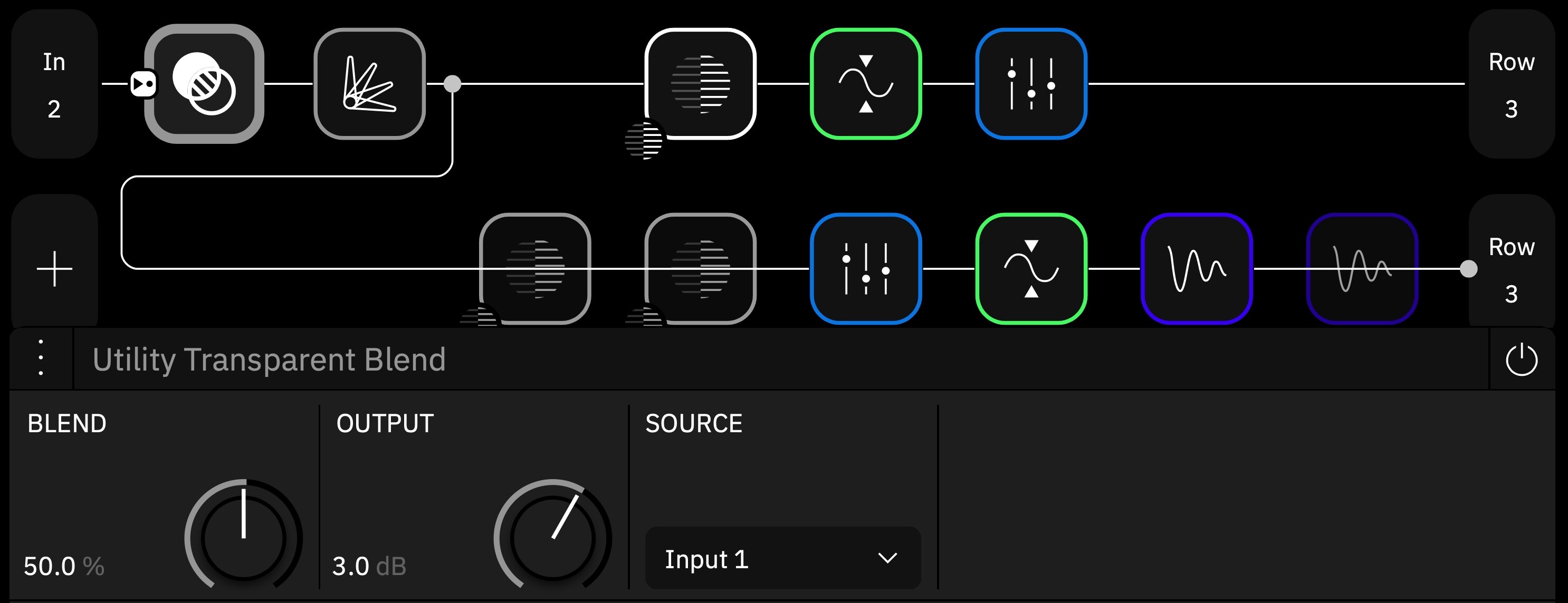

Thanks for the recommendations! I tried the Transparent Blend block and it seems to be working for me. One thing to keep in mind is that you may need to add a separate adaptive gate after the blend block (screenshot below). I like to use the gating that is built into the inputs, but the transparent blend grabs the signal BEFORE the gate. You can switch off the gating inside the input block and instead use a separate gate after the blend.
I also made another tweak…. I need to switch quickly between two instruments, and may have either one plugged into Input 1 or 2. Rather than using a stomp switch to control the blend block, I am planning to leave both inputs ON (50% blend with +3 dB Output boost). That way, I can grab either instrument, roll up the volume pot, and play. Thoughts? Potential problems?
