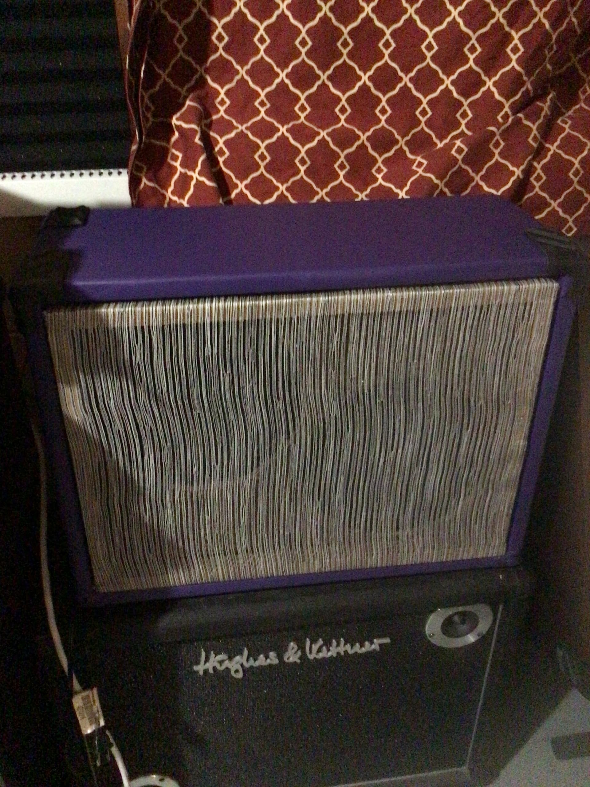

I’m using a pair of acoustic guitar amps as monitors. I found that they have the best sound for these after trying several FRFR/ PA cabinets. I’m using the Fender SFX2 amps. Sound as good as my studio monitors but they have that punch that comes from a guitar amp that is missing when you use a FRFR or pa speaker setup.

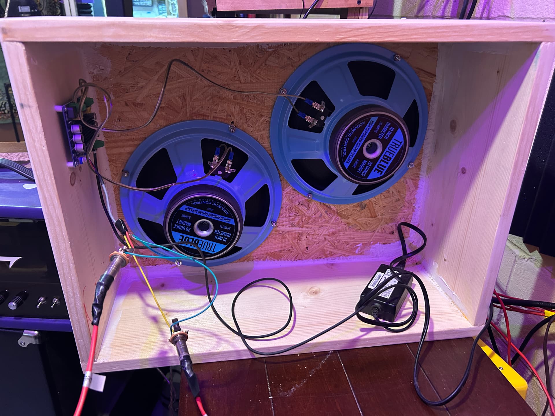

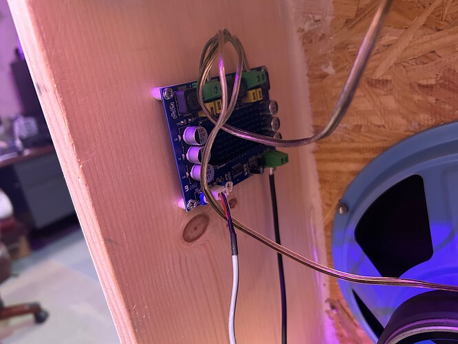

Just finished building a 2x10 stereo cab with acoustic GAMMA True Blue TB10G guitar speakers powered by a stereo class-d amp board (30 wattx2)). Small cab with a huge sound. It is my favorite by far and works well with impulse responses or not.
Highly recommend these speakers. This is the fourth fr cab for me. As well as alto powered speakers, studio monitors and power amps with cabs.

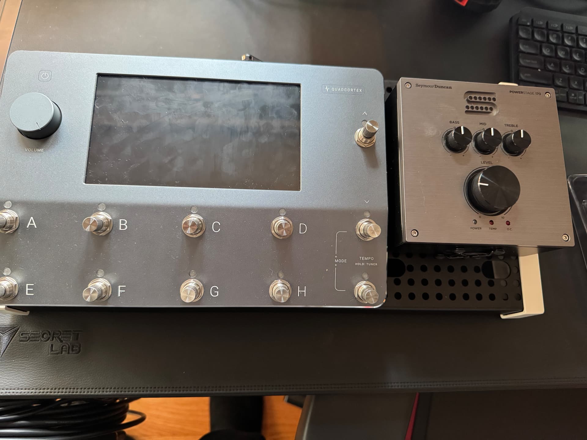

I am using a Seymour Duncan Powerstage 170 to drive a Matchless 212 cab for stage volume. Still sending outputs 1/2 to FOH but output 3 goes to the Powerstage, and then I run a long speaker cable from the Powerstage to my Matchless Cab. Just have a row with your amp and no IR/Cab block and it works great
